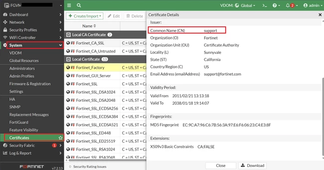

To validate that on FortiGate, go to System -> Certificates, review the subject of the Certificate 'Fortinet_Factory', and ensure that the CN is showing the serial number of the FortiGate.
If the CN is showing as 'FortiGate' or 'support' instead, run the following command in the FortiGate CLI, replacing FGVMXXXXXXXX with the FortiGate serial number.
execute vm-license FGVMXXXXXXXX
This operation will reboot the system!
Do you want to continue? (y/n)y
If the following error occurs while executing the above command, manually upload the license file using the procedure described in Technical Tip: Uploading the FortiGate VM license:
FortiCare response error 57.
Failed to download VM license.
If it is a hardware FortiGate, apply the following command:
FortiGate (root)# execute vpn certificate local generate default-ssl-key-certs
  • Check the output of:
FortiGate (root)# get vpn certificate local details
  • Check if the CN fields are changing or not, and if not, then open a ticket to the FortiGate team.
