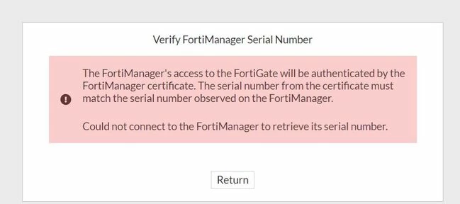

Starting in v7.6.2/v7.4.6/v7.2.10, the fgfm-peercert-withoutsn command is no longer supported, and FortiManager will always check the FortiGate's certificate for the FortiGate Serial Number.
Due to this change, the FortiGate needs to contain the unit Serial Number under the CN field. It is possible to load the entitlement file of the FortiGate to regenerate the certificate content.
From v7.0.12/v7.2.5/v7.4.3, there is a Special Notices in the certificate CN or SAN.
Error example:
'The FortiManager's access to the FortiGate will be authenticated by the FortiManager certificate. The serial number from the certificate must match the serial number observed on the FortiManager. Could not connect to the FortiManager to retrieve its Serial Number.'
The same error may also appear during attempts to connect a new FortiGate VM with FortiManager v7.4.7 and up. By default,  FortiManager denies FGFM connections from the VM platforms.  For more details, refer to the Release notes

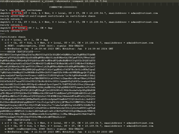

An external PC, with 'openssl' installed, can be used to verify that the correct certificate chain is used by the units:
openssl s_client -showcerts -connect <address>:<port>
nmap --script ssl-enum-ciphers <address> -p <port>
