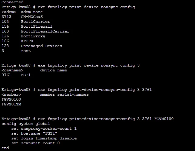

If the FortiGate HA status is not in SYNC, run the following command in FortiManager to check which configuration is not in SYNC between the primary and secondary FortiGate.
exe fmpolicy print-device-nonsync-config <adom-oid> <dev-oid> <primary-sn>
Use '?' in the command to show the OID and serial number:
exe fmpolicy print-device-nonsync-config ?
Below shows the sample output:
