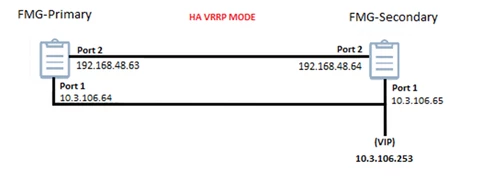

Sample diagram with Port & IP configuration:

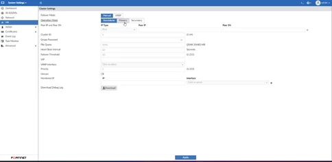

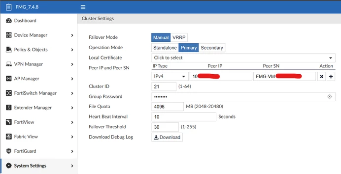

Configuration FortiManager HA cluster (Manual mode).
On the FortiManager-Primary device:
System Settings -> HA -> Operation mode select 'Manual’ -> ‘Primary’.
Configure the following details:
Failover Mode: Manual.
Operation Mode: Primary.
Peer IP and Peer SN:
Peer IP: x.x.x.17.
Peer SN: FMGVMTMxxxxxx8.
The HA settings below must be the same on the Primary and Secondary nodes:
Cluster-ID: 21.
Group Password: Fortinet@Test.
File quota: 4096.
Heartbeat Interval: 10.
Failover Threshold: 30.
On FortiManager-Secondary device:
System Settings -> HA -> Operation mode select 'Manual’ -> ‘Secondary’.
Operation Mode: Secondary.
Peer IP: x.x.x.19.
Peer SN: FMGVMTMxxxxxx4.
The HA settings below must be the same on the Primary & Secondary nodes:
Cluster ID: 21.
File quota: 4096.
After configuring the Primary & Secondary nodes of the FortiManager HA cluster, green arrows should appear on the GUI (Synchronization status).
On FortiManager Primary node:
On FortiManager Secondary node:

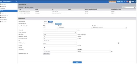

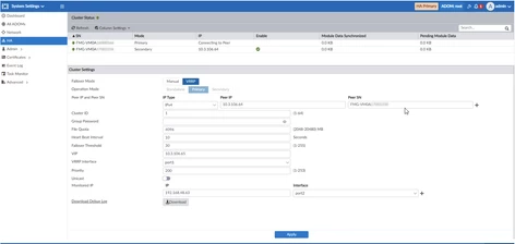

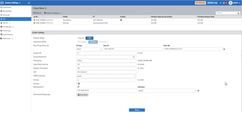

To use automatic failover for FortiManager-HA:
  1. In FortiManager, go to System Settings -> HA.
    As of version 7.2, a new Failover Mode setting is available in the FortiManager HA configuration menu. One can select Manual for manual failover or VRRP to enable automatic failover.
  2. Select VRRP as the Failover Mode, and configure the other settings required, including the VIP, VRRP Interface, Priority, Unicast, and Monitored IP.
On Primary FortiManager:
On Secondary FortiManager:
  1. When the monitored interface for the Primary FortiManager is unreachable or down, HA automatic failover will occur, and the Secondary FortiManager will automatically become the primary.

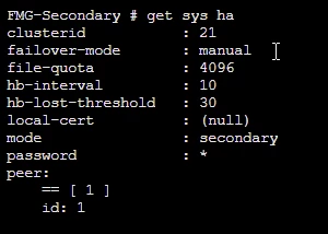

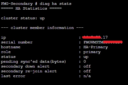

Troubleshooting commands:
The easiest way to verify if VRRP is allowed on the network is to run the sniffer on both ends:
diagnose sniffer packet any "proto 112"
On Primary-FortiManager:

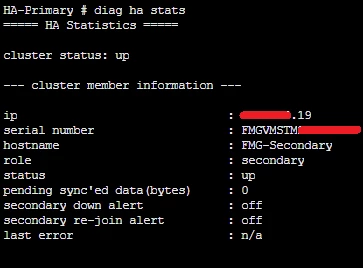

With these 2 commands, troubleshoot the status and the configured values for FortiManager-HA:
diagnose ha stats
get system ha
On Secondary-FortiManager:
With these 2 commands, troubleshoot the status and the configured values for FortiManager-HA.
diagnose ha stats
get system ha

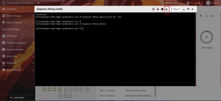

The following CLI commands help to troubleshoot FortiManager HA cluster issues: To stop the debug logs after collecting the required logs.
diagnose debug application ha  255
diagnose debug enable
diagnose debug disable --> To stop the debug logs after collecting the required logs.
diagnose debug reset --> To reset all the debug settings.
The debug output above can also be downloaded in a .txt file:
For example:

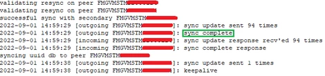

The debugging results during the HA cluster build operation can also be seen through the CLI. The capture below shows the negotiation of the FortiManager HA cluster from the primary node. The same operation can also be performed on the secondary node.
Config sync:
diagnose ha force-resync -------------------> Force full sync.
diagnose ha check-data auto-sync --------> Auto sync delta.
Refer to FortiManager CLI Reference: HA.

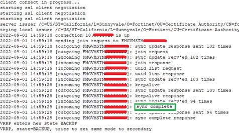

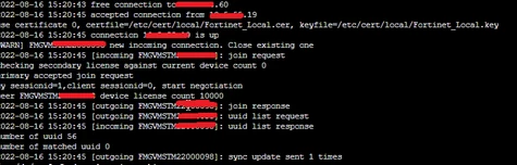

VRRP/Manual synchronization debug results:
Below are examples of output results of the HA cluster synchronization in VRRP mode on FortiManager.
These debugs are similar for HA configured in ‘manual mode’.
VRRP debugs on the Primary node:
VRRP debugs on Secondary node:

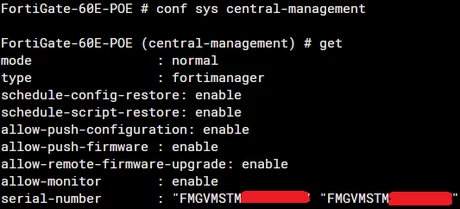

Once the HA cluster is built and synchronized, keepalive messages are sent between both nodes on the port chosen for this purpose:
On FortiGate central management, two Serial Numbers are configured (Both SNs belong to each FortiManager node of the cluster).
Both the HA manual and the VRRP modes use two Serial numbers.
If a node of the cluster becomes unavailable, the other SN will be automatically used.
Any Serial number will be removed from the configuration of the FortiGate central management in that case.
