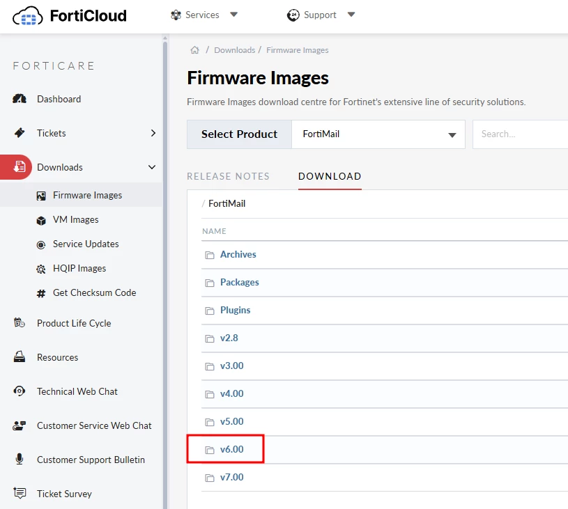

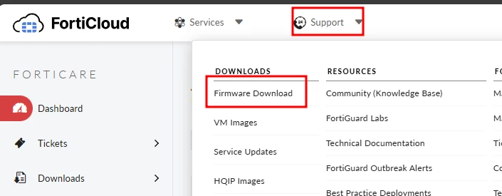

  1. Log in to the Customer Service & Support web portal here, and select the 'Download' option, followed by 'Firmware Images'.

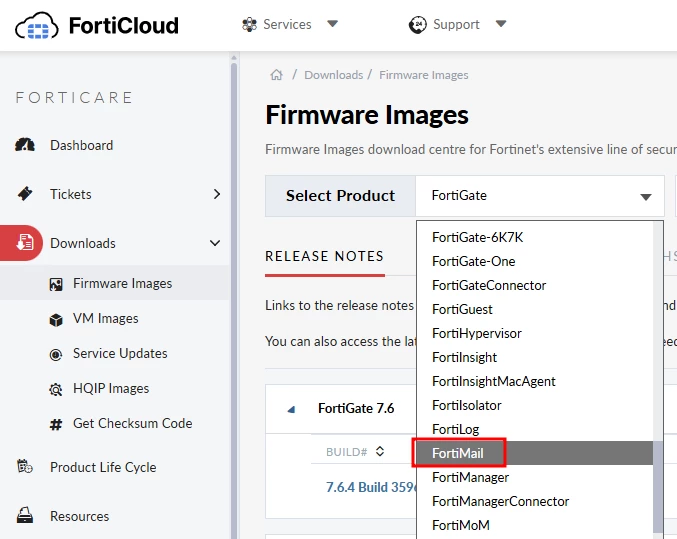

  1. Select 'FortiMail' from the product selection dropdown list.

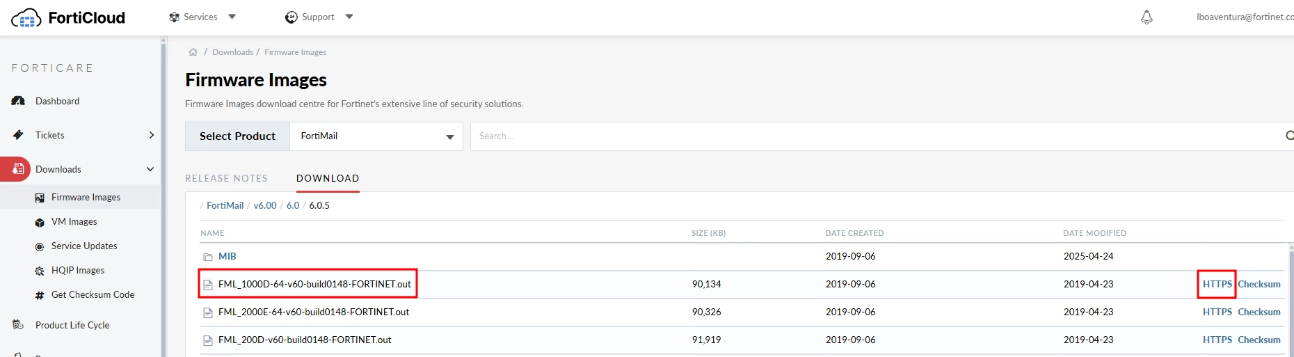

  2. Select 'Download' to get the available firmware list.
  3. Select the respective firmware version required, and select 'HTTPS' to starts download.
  4. Save the required firmware image at the local storage.

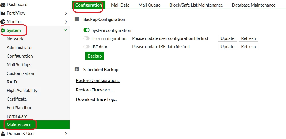

Manual upgrade firmware image via web UI:
  1. Login to FortiMail via web UI.
  2. Navigate to the following path in the browser:
    Go to: System -> Maintenance -> Configuration.

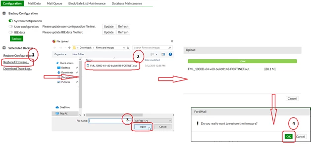

  1. Select 'Restore Firmware' to start the upgrade procedure.
    Select the 'Restore Firmware' button to bring up the file window.
    Select the firmware image file.
    Select 'open' to select the respective firmware image file.
    Select 'ok' to start the firmware upgrade procedure.

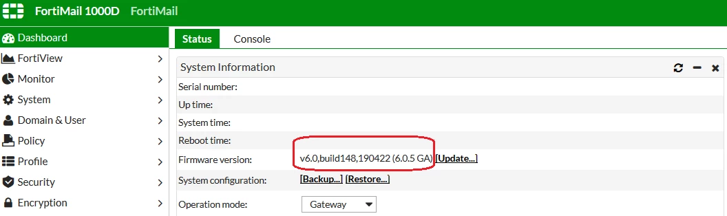

  2. Verify the FortiMail firmware version.
Go to: Dashboard -> Status -> System Information.

  5. Verify the FortiMail firmware version.
get sys status
Version:            FortiMail-1000D v6.0,build148,190422 (6.0.5 GA)

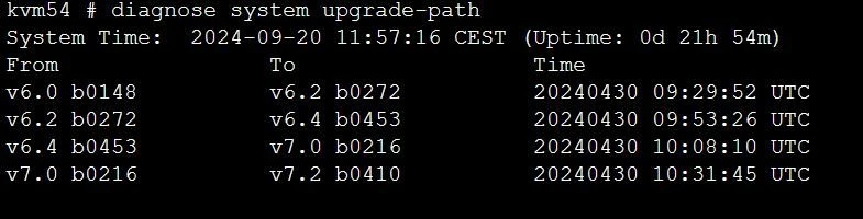

To view the upgrade path that was used to reach the current firmware version on the specific device/VM, the command is diagnose system upgrade-path.
