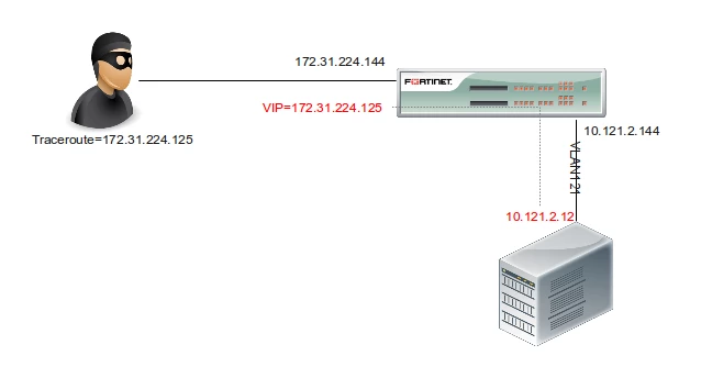

Firewall VIP, and traceroute.
Diagram:
Expectations, Requirements:
Some security tools report that VIP addresses 'answer' to traceroute requests, while ICMP_ANY or UDP traffics are not allowed by the firewall policies.
The traceroute tool relies on the TTL field in the IP header, which is contained in UDP packets. This TTL counter is decremented each time the packet is going through a router. While this counter is 1 or less, then the router must send an ICMP type=11, code=0 (Time Exceeded). The traceroute uses this ICMP message to figure out which host it encountered.
According to the RFC1812:
'If the TTL is reduced to zero (or less), the packet MUST be discarded, and if the destination is not a multicast address the router MUST send an ICMP Time Exceeded message, Code 0 (TTL Exceeded in Transit) message to the source.'
From the FortiGate point of view, the firewall VIP is seen as a logical IP address, and triggers a 'routing' from the 'external' address to the 'mapped' address, and then the TTL algorithm from RFC1812 is used.
There is no way to disable the sending of ICMP TTL Exceeded in Transit message, as this behavior is compliant with the RFC1812.
Configuration:
The extract of the configuration shows that there is a VIP defined between a real server (10.121.2.12 on VLAN121), and a virtual public IP address 172.31.224.125 on port2. Only HTTP traffic is allowed by the firewall policy port2 (any host) to the real server (VLAN121) through the VIP.

Verification:
From a host connected on port2, execute 'traceroute 172.31.224.125'.
The following outputs are captured on the FortiGate:
The FortiGate receives a packets from the traceroute tool, to the VIP, with a TTL of 1.

Troubleshooting:
It may be observed that the traffic does not go through the FortiGate. There is no egress traffic on the VLAN121.
