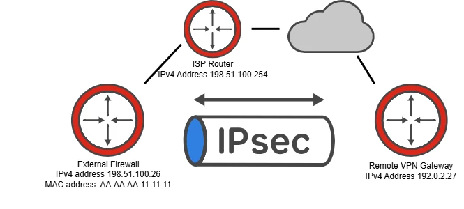

Original topology:

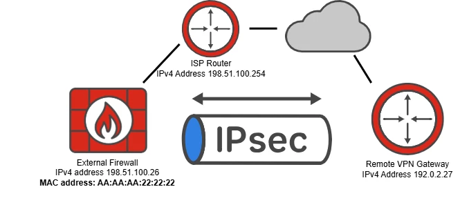

Topology after migration:

  • The packets have a destination MAC address matching the previous firewall, which does not match the FortiGate's external address. The MAC address can be seen by taking a packet capture with verbosity level 6. The destination MAC address appears in the first 6 bytes of the Ethernet frame. In the example below, the incoming frame has destination MAC address 'AA:AA:AA:11:11:11'.

The issue occurs because the directly connected upstream router has cached the destination MAC of the old external firewall for the IKE session and is not updating it with the newly observed MAC address. Reboot or power cycle the upstream router or modem (labelled 'ISP Router' in the topologies above) to resolve the issue. This will update the destination MAC address sent by the directly connected device.

If it is not possible to reboot or power cycle the old device, updating the FortiGate's mac address for the interface may work around the issue. See this article: Technical Tip: How to change the Interface's MAC addresses on FortiGate.
