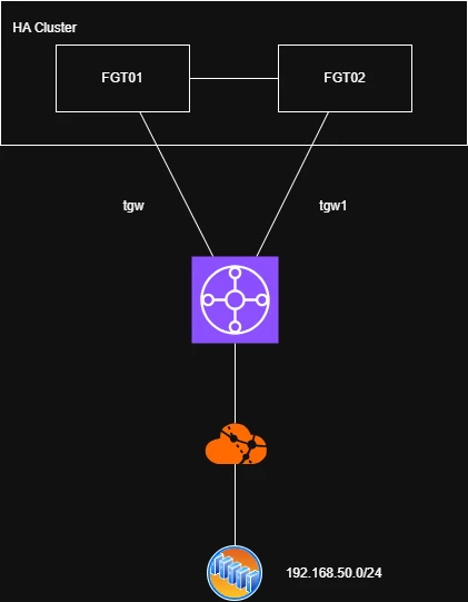

Topology:
In this topology, the design of the GRE tunnel connection failover between FortiGate HA Cluster and AWS Transit Gateway is as below:
  • When FGT01 becomes the primary, the GRE tunnel tgw will be active to route traffic between FortiGate and the application subnet 192.168.50.0/24.
  • When FGT02 becomes the primary, the GRE tunnel tgw1 will be active to route traffic between FortiGate and the application subnet 192.168.50.0/24.
  • Server Load Balancing was configured on FortiGate to perform DNAT to internal/application servers:
The connection worked fine when FGT02 remained the primary unit. The following statistics show the routing table, GRE tunnel status, and virtual server status when FGT02 acts as the primary:
