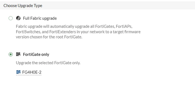

  1. Navigate to System -> Firmware and select 'Upgrade All'.
  2. Select 'FortiGate Only.'

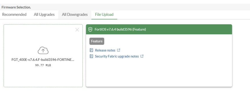

  1. On 'Firmware Selection,' select the 'File Upload' tab and upload the firmware file.

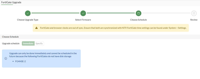

  1. On the next menu, the option to select a schedule is grayed out and only 'Immediate' is available, with the warning displayed below:
As the error suggests, there is no disk storage on this device, and the error is expected. The presence of a storage disk can be confirmed by issuing the following command:
