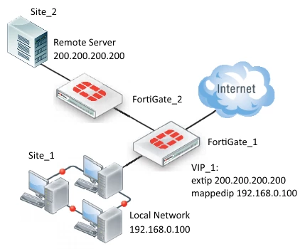

"FortiGate_1" VIP configuration:
config firewall vip
edit "VIP_1"
set extip 200.200.200.200
set extintf "wan1"
set mappedip 192.168.0.100
Scenario:
- New Virtual IP "VIP_1" was created on "FortiGate_1", but it wasn't still applied to any firewall policy.
- "VIP_1" external IP is the same as IP address of existing "Remote Server" on "Site_2" (200.200.200.200).
- "VIP_1" mapped IP is 192.168.0.100 which belongs to the "Local Network" workstation on "Site_1".
- "FortiGate_1" has working route for IP 200.200.200.200 in its routing table.
- However "Remote Server" became unreachable immediately for any users (LAN and Internet).
- After deleting "VIP_1" object from "FortiGate_1" the "Remote Server" became reachable again for all users.
