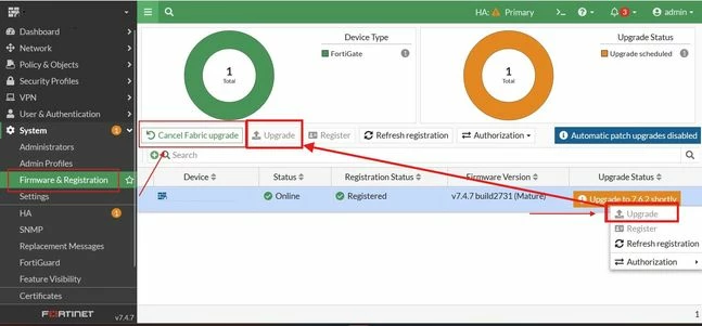

The Upgrade button under FortiGate -> System -> Firmware is grayed out in some cases, even when a new version of the firmware is available, preventing the upgrade process from proceeding. See the screenshot below:
This issue occurs when the firmware upgrade is triggered via Fabric Upgrade instead of the standard Upgrade option in the FortiGate GUI.

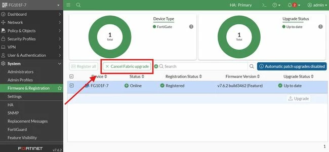

Note that:
  • If the FortiGate is not part of a Security Fabric or is operating as a standalone unit, it will not initiate a firmware installation through Fabric Upgrade.
  • In such cases, the upgrade option will remain grayed out until the Fabric Upgrade process is canceled.
  • Using the following command Fabric Upgrade process can be canceled using the CLI:
execute federated-upgrade cancel

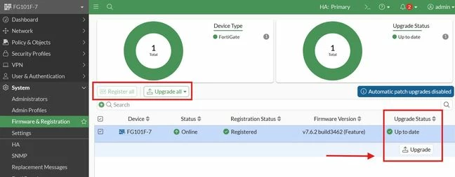

Once the Fabric Upgrade is canceled, the Upgrade option will become available, allowing the firmware upgrade to proceed as expected.
Note: Make sure that the admin user has a read write access to the FortiGate. Otherwise, the user will see the upgrade option greyed out.
