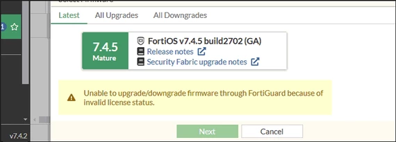

This article describes how to resolve an issue where it is not possible to upgrade/downgrade firmware, and the error message 'Unable to upgrade/downgrade firmware through FortiGuard because of invalid license status' is thrown despite the FortiGate having a valid license.
This issue happens when the FortiGate is in HA, and one of the HA members does not have a valid license.

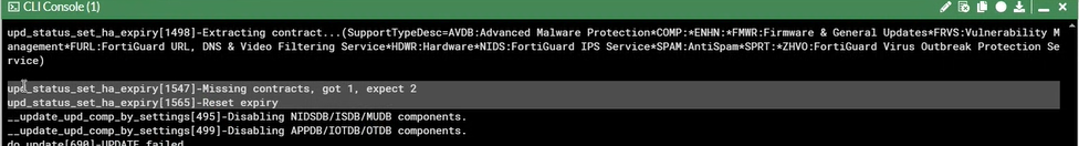

In an HA cluster with 2 members, 2 contracts are expected. If only 1 device is being licensed, the following error will be observed when the above command is enabled:
