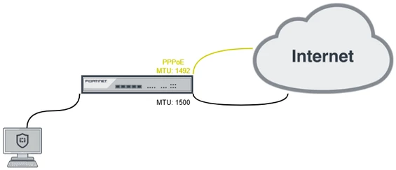

This article describes how to fix an issue where the user is unable to login on SSL VPN with 2 ISPs having different MTUs. For example: one ISP is a PPPOE interface, and the other one is a regular physical interface. FortiClient gets stuck at 40 percent connection, and TLS handshake is not successful.
FortiGate v7.4.
Network Topology:

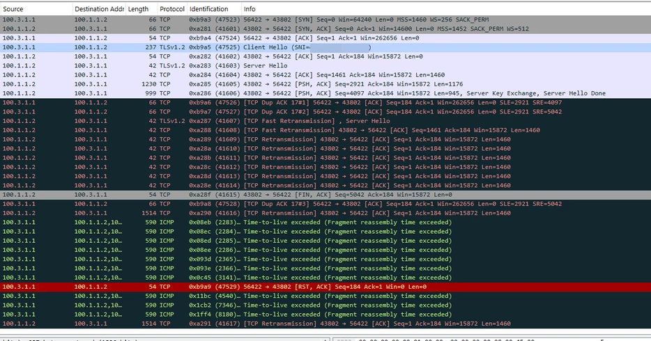

The user will try to login on FortiClient with SSL VPN and it will fail. Fragmented packets are observed and the client sends out 'icmp: ip reassembly time exceeded'. This indicates that the Client did not receive all of the fragmented packets and it discards the initial fragment packets that it received.
Packet Capture:
diagnose sniffer packet any 'host 100.3.1.1' 6 1000 l
Solution:
If different network routes have different size limits for data (MTU), and some routers cannot properly handle split-up data (fragments), it can cause issues with any incoming TCP connections (local in / passive local) to the FortiGate. It is necessary to check on every hop where the fragmented packets are getting dropped. The user can still login on SSLVPN if the fragmented packets are not getting drop.
