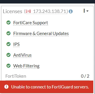

This article describes the possible reasons why FortiGate is unable to connect to FortiGuard servers and offers steps to troubleshoot the problem.
The 'Unable to connect to FortiGuard servers' error message can be seen in two places under Dashboard -> Status -> Licenses.
Go under System -> FortiGuard -> FortiGuard Updates.
v7.6.x:
  1. Go to Dashboard -> Status -> Licenses.
  2. Go to System -> FortiGuard -> Subscriptions -> Licensed.

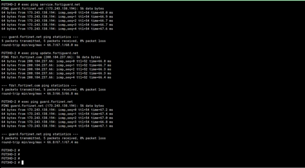

  1. Check connectivity to FortiGuard servers (Troubleshooting Tip: FortiGate FortiGuard Servers) by checking to ensure FortiGate correctly resolves DNS with the following hostnames:
  • securewf.fortiguard.net is for the HTTPS service.
  • usservice.fortiguard.net = UDP - USA servers.
  • ussecurewf.fortiguard.net = HTTPS - USA servers.

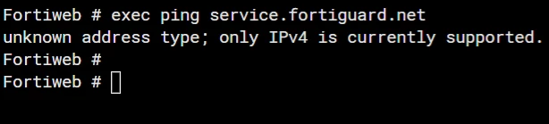

execute ping service.fortiguard.net
execute ping update.fortiguard.net
execute ping guard.fortinet.net
execute ping securewf.fortiguard.net
execute ping usservice.fortiguard.net
execute ping ussecurewf.fortiguard.net
If DNS resolves but there is no ping, check the routing table (get router info routing-table all) to determine the best route for FortiGuard services (if ISDB is used in SD-WAN/policy route or static route) or the default route.

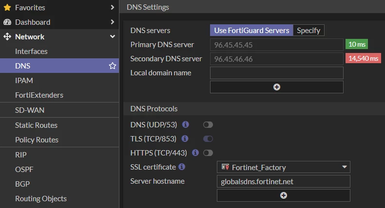

If the DNS resolves and it is able to ping, move to Step 2. If it is not resolving, check the DNS configuration.

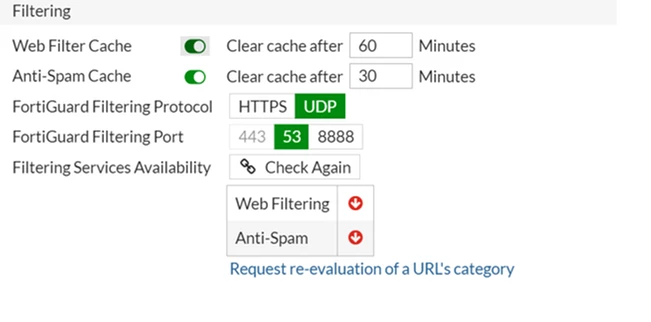

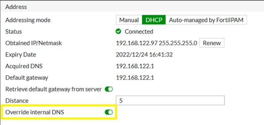

Important note: If the interface that is being used for outbound communication is in DHCP mode, it receives IP addresses and DNS addresses from it.
If the option 'Override internal DNS' is enabled, it means that it will override the system's DNS settings with the ones that it received from DHCP, and it might not be able to resolve the domains to the correct addresses, resulting in failed FortiGuard communication:

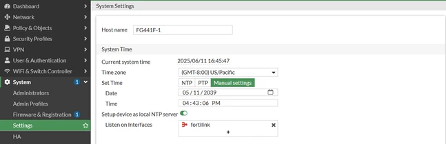

Another possible FortiGuard connectivity failure scenario is one where the FortiGate 'Time Settings' are set up manually with the wrong time and date. The solution is to either adjust the time settings or switch to using an NTP server.
For example:
The time settings menu can also be accessed through the CLI:
config system ntp
    set ntpsync [enable | disable]
    set server-mode [enable | disable]
Note: An incorrect system time can also break HTTPS/TLS connections to FortiGuard because FortiOS checks the current date against the FortiGuard server certificate's validity window - if the clock is wrong, a perfectly valid certificate can look expired or not yet valid, and the connection gets blocked.
This is a separate issue from DNS or routing and is fixed the same way, by correcting the date manually or pointing the unit to a working NTP server.

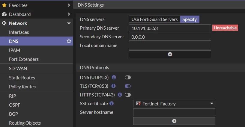

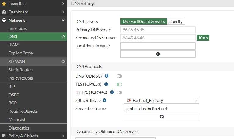

One of the most possible causes is when the 'Use FortiGuard Servers' option is changed to 'Specify' for use with an internal DNS server, without switching the DNS protocols or validating if the new DNS Server supports DoT (default setting of FortiGuard servers), which uses TCP 853, or DoH, which uses TCP 443.
If that happens, the DNS server will be unreachable, and DNS resolution will not work, as shown in the screenshot below.

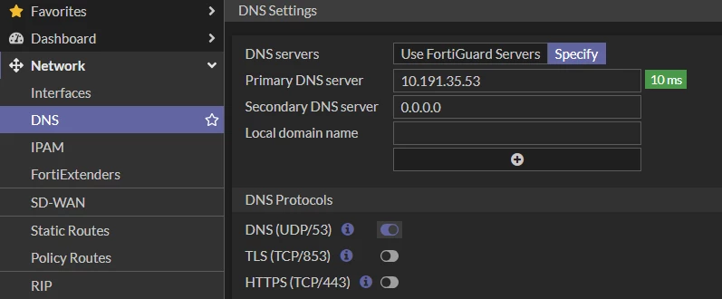

After changing to UDP 53, the DNS server will be reachable, and resolution should start working. The following are the commands to change the protocol via CLI:

When DNS-over-TLS is enabled, it will use TCP/853. Disable the use of UDP/53.
For v7.0 and above:
  • Where DoT uses TCP/853, and cleartext is used for UDP/53.
config system dns
    set protocol cleartext
To use DoT or DoH, make sure to use the DNS server hostname for the DNS server configured.
For example, if 8.8.8.8 is configured as a DNS server, the server hostname for it is 'dns.google':

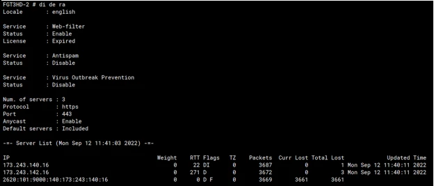

  1. Run 'diagnose debug rating' in the CLI:
The output of the command 'diagnose debug rating' displays flags next to the servers:
  • I=Initial: The server initially connected to validate the license and fetch the server list. Typically, only one server will have this flag.
  • D=Default: The IP address FortiGate received when resolving the name service.fortiguard.net. If the administrator has not overwritten the FortiGuard FQDN or IP address in the FortiGuard configuration, there are usually two or three servers with this flag.
  • S=Serving: The IP address FortiGate received from FortiManager.
  • T=Timing: The server is not replying to FortiGate queries.
  • F=Failed: The server is down.
If all servers in the list have failed, this may mean either that all FortiGuard servers on the Fortinet side are down (unlikely) or that this FortiGate has a problem reaching them at the network level.

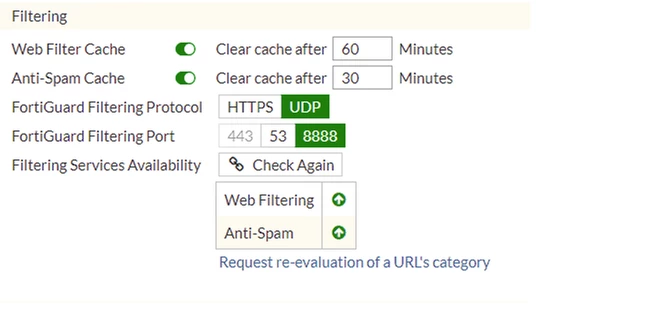

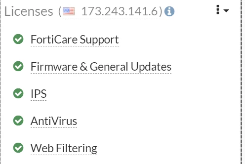

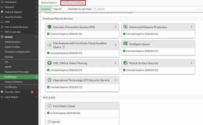

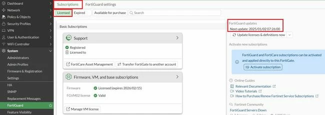

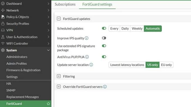

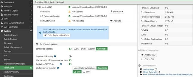

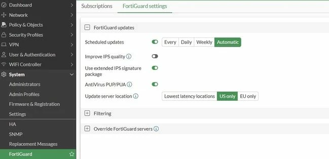

  1. Verify Antivirus & IPS Definition and Filtering Services: Check Antivirus & IPS Definition under System -> FortiGuard -> AntiVirus & IPS Updates -> Update Antivirus and IPS Definitions.
v7.2.x:
The active subscriptions under System -> FortiGuard are being updated with the 'FortiGuard Updates'; the options for 'AntiVirus & IPS Updates' have been removed.

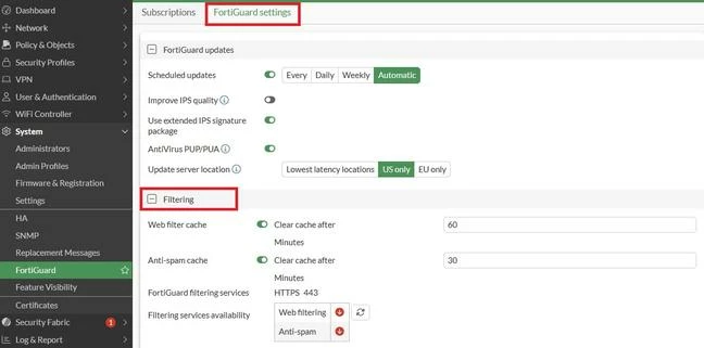

v7.6.x:
The active subscriptions under System -> FortiGuard -> Subscriptions -> Licensed are being updated with the 'FortiGuard Updates' in System -> FortiGuard -> FortiGuard settings.
Check Filtering Services under System -> FortiGuard -> Filtering.
Check Filtering Services under System -> FortiGuard -> FortiGuard settings, and then expand the Filtering option.

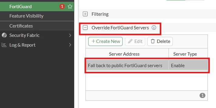

Note: Also, check if the override FortiGuard Servers are enabled. As displayed in the picture below.
If the Server is set to disabled, the following logs appear in the debug output:
upd_daemon[1889]-Received update request from pid=5310
upd_daemon[1709]-Found cached action=00000002
do_update[723]-Starting now UPDATE (final try)   <----- Trying to update server.
upd_fds_create_list[1295]-No server found for update[00000001] <----- Unable to reach servers.
update_upd_comp_by_settings[494]-Disabling FLEN components.
update_upd_comp_by_settings[498]-Disabling NIDSDB/ISDB/MUDB components.
update_upd_comp_by_settings[502]-Disabling APPDB/IOTDB/OTDB components.
update_upd_comp_by_settings[510]-Disabling AVEN components.
update_upd_comp_by_settings[514]-Disabling AVDB/FLDB/MMDB components.
do_update[734]-UPDATE failed <----- Update failed.
calculate_next_update_time_auto[192]-interval=20, cur_time=Wed Aug
next_update=Wed Aug

  1. To configure FortiGate to use worldwide servers or only servers located in the USA, run the following command in the CLI:
config system fortiguard
    set update-server-location [usa/any]
Note: In the latest version, the option has been changed as follows:
    set update-server-location [automatic/usa/eu]
  • automatic: FortiGuard servers chosen based on the closest proximity to the FortiGate unit.
 set update-server-location <location>
This can also be done under System -> FortiGuard -> FortiGuard Update in the GUI.
v7.6.x:
This can also be done under System -> FortiGuard -> FortiGuard settings.

The following command can also fix various issues with FortiGuard servers. In this example, 212.48.23.12 is used as the IP for the interface to the ISP router.
    set fortiguard-anycast disable
    set protocol udp
    set port 8888
    set sdns-server-ip 208.91.112.220 173.243.140.53 210.7.96.53
    set ddns-server-ip 173.243.138.225
    set source-ip 212.48.23.12
config system dns
    set primary 8.8.8.8
The source IP should match the IP address on the WAN port of the FortiGate (ISP port). If the Source IP is changed, DNS and FortiGuard settings should be changed as well.
Note: Despite changing the FortiGuard settings to disable anycast and configuring the UDP protocol to reach the FortiGuard servers, the connection still fails because the DNS servers will still use the 'DNS over TLS' settings, which is a default setting. In this case, public IPs will be reachable, but DNS resolution fails.
Changing the DNS settings to use 'DNS over UDP' will help resolve the domain names properly.

License errors may be found in two places, as shown below:
  • Dashboard -> Status -> Licenses.
  • System -> Config -> FortiGuard.
  1. If DNS issues occur, the following output will be seen in the CLI:
Verify DNS settings in FortiWeb under Network -> DNS. Verify the reachability of the DNS IP. If the DNS is private, change to a public DNS and verify the connectivity. If the DNS resolves, check reachability. If there is a firewall, allow ICMP for FortiWeb.

FortiGuard licenses and the communication to FortiGuard are viewable via GUI through System -> FortiGuard, as well as through the CLI using the following commands:
diagnose autoupdate versions
The output is quite long, but it is possible to pipe the output to grep:
diagnose autoupdate versions | grep -A6 "IPS Attack Engine"
If the communication to FortiGuard is OK, but the Web Filter is still shown as 'disabled' in the 'diagnose debug rating' output:
Locale : english
Service : Web-filter
Status : Disable
Service : Antispam
Status : Disable
Service : Virus Outbreak Prevention
Status : Disable
The web filter should be licensed:
