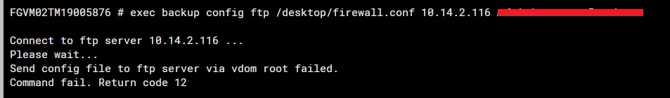

To backup the config to FTP we run the following command:
execute backup config ftp <filename> <ftp server>[:ftp port] <username> <password>
Follow this KB article is the error code is 12, If the error code is 5:
Troubleshooting Tip: Unable to backup FortiGate config to external FTP server - Send config file to ftp server via vdom root failed. Command fail. Return code 5
Error: 'Send config file to ftp server via vdom root failed. Command fail. Return code 12'
12 FTP_INPUT_ERR Error reading INPUT or STDIN.

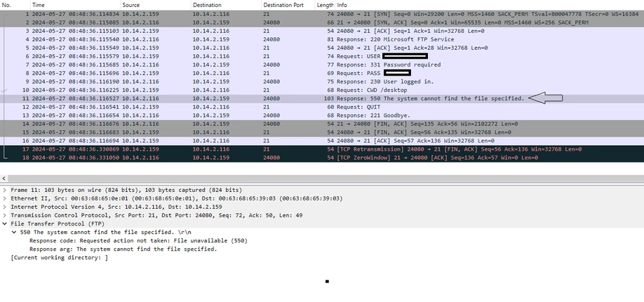

Generally, error 12 occurs when the destination folder is not available. Do a packet capture on FortiGate:
diag sniffer packet any 'host <FTP server>' 6 0 l
Follow:
Technical Tip: How to import 'diagnose sniffer packet' data to WireShark to convert the sniffer output to PCAP.
From GUI:
Go to Network -> Packet capture (upto 7.0.x models) or Network -> Diagnostics (v7.2.x and above). Put a filter for the FTP server IP as the host
Packet capture will show that the directory is not correct:
Visit the FTP server and check the correct file directory to use.
It is also possible to use Filezilla to list the directory that allows access.
