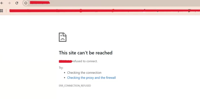

After upgrading to firmware version 7.6.4 or later, the GUI may display an 'ERR_CONNECTION_REFUSED' error as shown in the image below:
In the below sniffer output, it can be seen that the firewall is sending the RST packet in response to the SYN (connection initiation).
diagnose sniffer packet any "host 10.2.2.1 and port 443 " 4 0 l
interfaces=[any]
filters=[host 10.2.2.1 and port 443 ]
2026-02-04 14:38:20.133931 port1 in 10.2.2.1.58189 -> 10.1.1.1.443: syn 3366770127
2026-02-04 14:38:20.134024 port1 out 10.1.1.1.443 -> 10.2.2.1.58189: rst 0 ack 3366770128
2026-02-04 14:38:20.387212 port1 in 10.2.2.1.63535 -> 10.1.1.1.443: syn 3710423967
2026-02-04 14:38:20.387296 port1 out 10.1.1.1.443 -> 10.2.2.1.63535: rst 0 ack 3710423968
