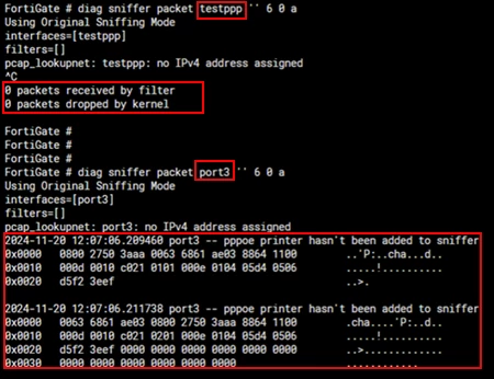

  1. It is recommended to perform packet capture on the physical interface where PPPoE is configured:
diagnose sniffer packet <physical_interface> '' 6 0 a
Trying to capture PPPoE negotiation packets on the dynamically created PPPoE interface will not show any packets, as the PPPoE session is not yet established.

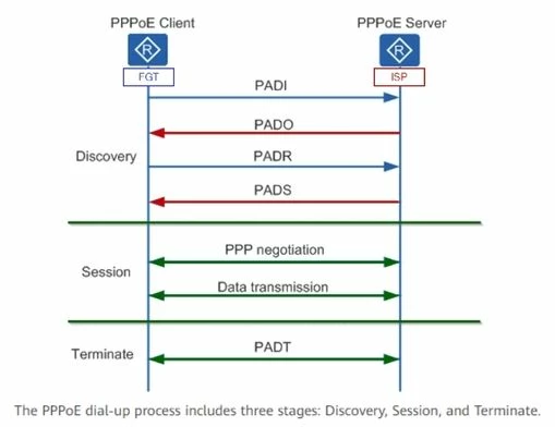

  1. Verify if the PPPoE negotiation is successful:
Client to server: Initiation (PADI) -> Server to client: Offer (PADO) -> Client to server: request (PADR) -> Server to client: session confirmation (PADS).
PPPoE consists of two phases:
  • Active Discovery Phase.
  • PPP Session Phase.
Active Discovery Phase:
  1. The client sends a broadcast Initiation (PADI).
  2. The server responds with unicast Offer (PADO).
  3. The client sends a unicast Request (PADR).
  4. The server responds with a unicast Session (PADS).
PPP Session Phase:
  1. Link Control Protocol (LCP).
  2. PPP Authentication (PAP / CHAP).
  3. Network Control Protocol (NCP) -> IPCP.
A graphical representation would look like this:

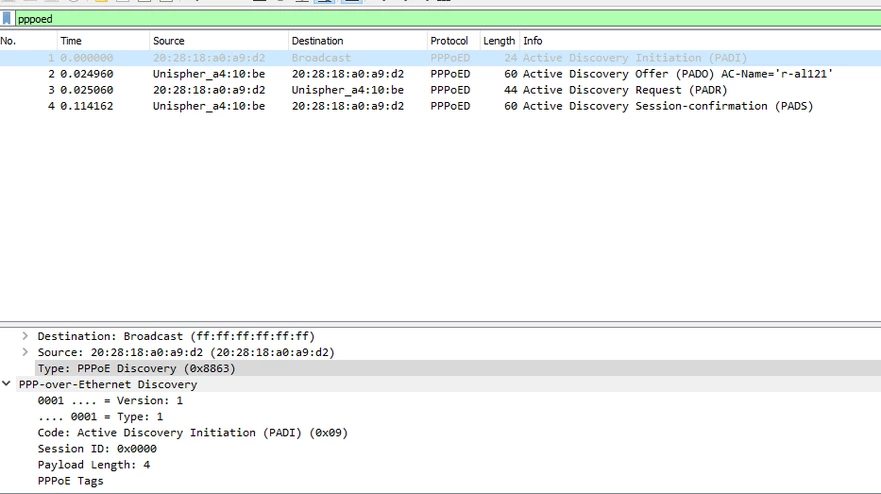

For the Discovery stage, a sample packet capture might look like this:

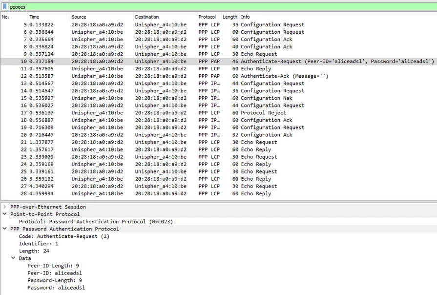

For the Session stage, a sample packet capture might look like this:
If the transaction is valid, it will be possible to see the transactional information in the Wireshark:

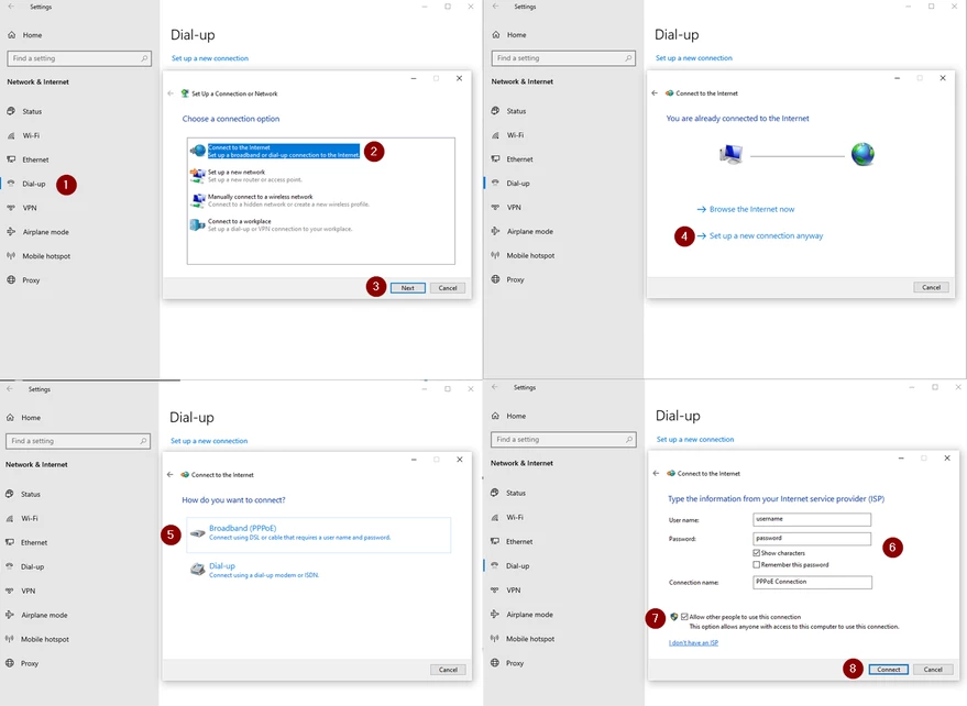

To help isolate the issue,  use the Windows machine to determine if it does not respond to broadcast. Similar to the image below.
In these cases, it is required to check on the physical layer and/or logs on the ISP router to see if it received the broadcast packet and responded accordingly.
