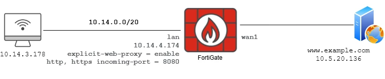

Example Topology:
For an overview of explicit proxy operation, see Troubleshooting Tip: Example of WAD debugging for explicit proxy.
Enabling the explicit web proxy on a FortiGate device or a particular VDOM triggers a hybrid inspection approach that combines flow-based and proxy-based processing.
One or more configured interfaces monitor the specified explicit proxy port (default: 8080) for incoming web browser connections. All HTTP and HTTPS traffic arriving on that port is accepted and handled if it matches a defined explicit web proxy policy.
Use the following steps to troubleshoot the explicit proxy:

Next, verify the explicit proxy port on which the firewall is listening:
config web-proxy explicit
    set status enable
    set http-incoming-port 8080
    set https-incoming-port 8080
As per the above configuration, listening is being done on the LAN interface IP: 10.14.4.174 with port 8080.

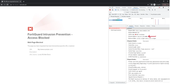

Step 3:
Once ensuring the user machine is enabled with an explicit proxy, the next step is to make sure that traffic to the website in question is forwarded to the proxy.
One simple way to test is to go to the browser and then open Developer Tools -> Network, and now it is possible to try to access the website.
Once the website access is done, it should be possible to see the requests in the developer tools, select the domain request, and 'Headers'.
Under the Headers, it should show the remote address field, which should be the proxy IP and port. If it is not the proxy IP and port, then the user machine is not forwarding the traffic to the explicit proxy for the website.
