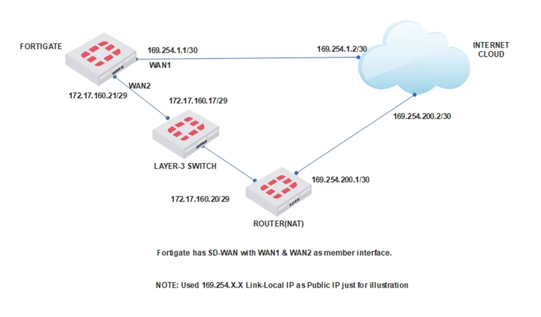

FortiGate has SD-WAN with WAN1 & WAN2 member interfaces.
WAN1 has direct internet link to the ISP with Public IP address 169.254.1.0/30.
Note: 169.254.X.X Link-Local IP used as Public IP just for illustration.
WAN2 is connected to the internet via internal Layer-3 switch and ROUTER. They all are in the same network 172.17.160.16/29.
SD-WAN member interface WAN2 is configured with Layer-3 switch (172.17.160.17) as gateway. In turn, Layer-3 switch is configured with ROUTER (Which is connected to the ISP).

EXPLANATION ABOUT WHY THE GATEWAY HAS BEEN CHANGED FOR FORWARDING TRAFFIC.
For WAN2, when local traffic originated by the health-check for destination 8.8.8.8 with 172.17.160.21 as a source
Gateway Layer-3 Switch with IP address 172.17.160.17 receives data packet from a 172.17.160.21 on a network to which it is attached.
The gateway, Layer-3 Switch, checks its routing table and obtains the address 172.17.160.20 of the next gateway, ROUTER, on the route to data packet's destination network 8.8.8.8.
As ROUTER (172.17.160.20/29) and the FortiGate identified by the source address (i.e 172.17.160.21/29) of IP packet are on the same network, Layer-3 switch sends ICMP Redirect message to the
FortiGate on WAN2.
The ICMP Redirect message advises the
FortiGate to send its traffic for Network (here, 8.8.8.8) directly to gateway ROUTER as this is a shorter path to the destination. Hence, route cache (rtcache) list is displaying the gateway as 172.17.160.20 for WAN2.
As WAN1 and WAN2 are the member interface of SD-WAN, gateway change has been seen for WAN1 as well.

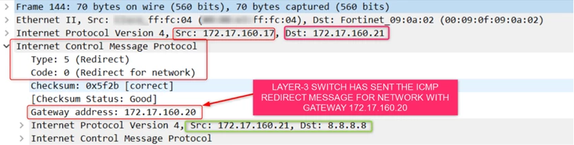

PACKET CAPTURED ON FORTIGATE ILLUSTRATING THE ICMP REDIRECT MESSAGE RECEIVED FROM LAYER-3 SWITCH.
Due to gateway change, WAN2 traffic is not impacted as new gateway belongs to the same network and hence health-check for the WAN2 is UP.
However, WAN1 gateway changed to the private IP 172.17.160.20 and hence WAN1 health-check is down.
