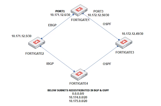

- FORTIGATE2 is advertising 0.0.0.0/0, 10.174.0.0/20 and 10.175.0.0/20 routes to FORTIGATE1 via EBGP.
- Also, FORTIGATE3 is advertising the same routes 0.0.0.0/0, 10.174.0.0/20 and 10.175.0.0/20 to FORTIGATE1 via OSPF.
- FORTIGATE1 will install all 3 routes received from EBGP as EBGP has administrative distance of 20 which is less than administrative distance of OSPF which is 110.
- However, the requirement is that only default route should be preferred via OSPF and rest two routes 10.174.0.0/20 & 10.175.0.0/20 should be preferred via EBGP.
- All BGP routes are active in the routing table.

To achieve the requirement that only default route should be preferred via OSPF and rest two routes 10.174.0.0/20 & 10.175.0.0/20 should be preferred over EBGP, on FORTIGATE1, increase EBGP Administrative Distance more than 110 only for 0.0.0.0/0 using below steps.
-Create the Access-list only for Default-Route with exact-match enable
#config router access-list-Increase Distance for default route to 120 under admin-distance for EBGP neighbor 10.171.12.5
edit "DEFAULT_ROUTE"
set comments "MATCH ONLY DEFAULT ROUTE"
config rule
set prefix 0.0.0.0 0.0.0.0
set exact-match enable
#config router bgp-Soft Clear the BGP neighbor
config admin-distance
set neighbour-prefix 10.171.12.5 255.255.255.255
set route-list "DEFAULT_ROUTE"
set distance 120
#execute router clear bgp ip 10.171.12.5 softRESULTS:
