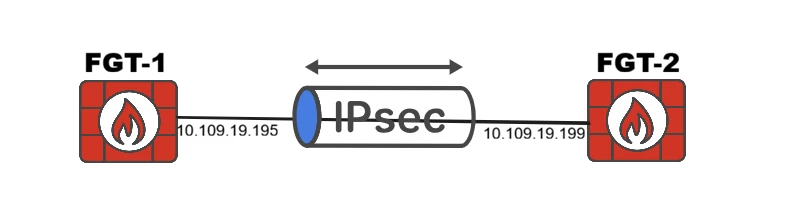

Topology:

This issue is occurring due to a mismatch in the protocol used for the IPsec tunnel on the firewall. To resolve it, change the transport port on FGT-1 to UDP:
    edit "IPSEC"
        set transport udp
