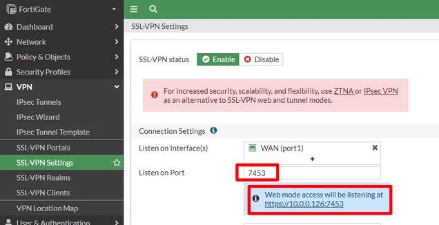

To troubleshoot getting no response from the SSL VPN URL:

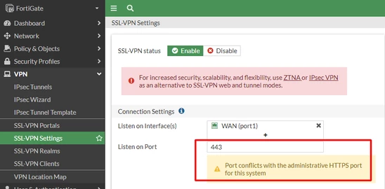

Make sure that the port used under the SSLVPN settings is not the same port used for admin access. Admin settings can be checked on System -> Settings -> Administration Settings.
Starting from v7.4, SSL VPN GUI menu visibility is disabled by default. If SSL VPN web mode and tunnel mode were configured in a FortiOS firmware version before upgrading to FortiOS v7.4.1 and above, then the VPN -> SSL-VPN menus and SSL VPN web mode settings will remain visible in the GUI.
To enable the SSL VPN GUI menu, go to System -> Feature Visibility and toggle the SSL VPN radio button.

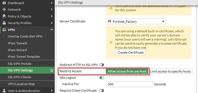

  • Go to VPN -> SSL-VPN Settings. Check the SSL VPN port assignment. Make sure the port number does not conflict with HTTPS or Virtual IPs.
  • Check the restricted access setting to ensure there is no restriction for hosts trying to connect.

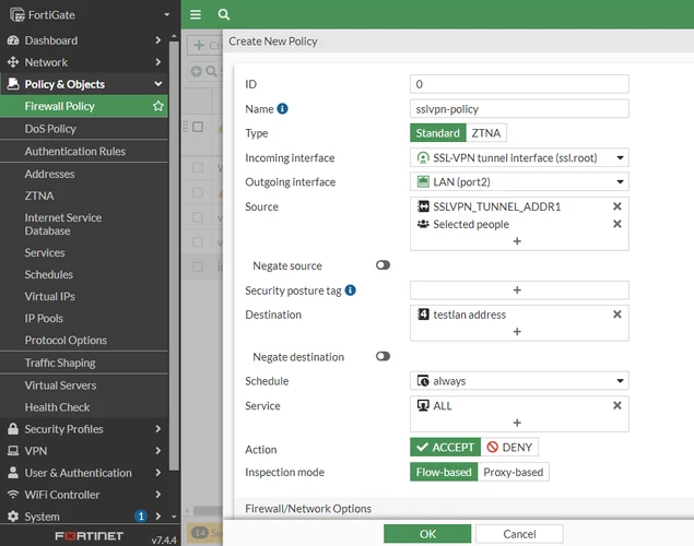

  • Go to Policy & Objects -> Firewall Policy. Check that the policy for SSL VPN traffic is configured correctly.

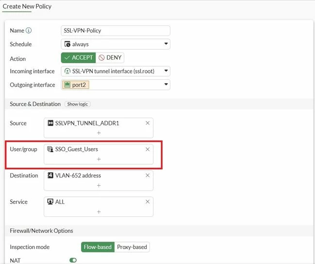

  • From v7.6.x and above, the User/Group option has been moved to a separate dedicated field, as shown below:

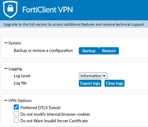

To enable DTLS in FortiClient:
Go to Settings and enable 'Preferred DTLS Tunnel'.
