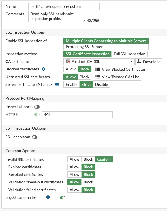

Description This article describes how to handle an issue where SSL certificate inspection does not block sessions with expired certificates.
Scope FortiGate.
In some scenarios, the configuration of Common Options in the SSL/SSH Inspection profile does not guarantee certificate expiration date, revocation, or other parameters.
For testing purposes, use the following URL: https://expired.badssl.com.
Despite how the feature has been enabled in the GUI:

[2172@8]create_run_mode: SSL CA name: Fortinet_CA_SSL, untrust CA name: Fortinet_CA_Untrusted, VDOM: 0, enable: 0, mode: 2, verifyca: 1, cert action: untrusted: 0, expired: 1, revoked: 1timeout: 1,
failure: 1, whitelist: 0
The result of the validation is PASS:
[2172@8]ips_asm_set_seq: set asm seq: 07a8e573
[2172@8]ips_dsct_session_loop: serial=17144628 run: http2
[2172@8]ips_process_event: ctx 0: 0 => 3
[2172@8]ips_handle_pkt_verdict: pass a packet, size=60
This is expected behavior. Common Options are only validated by the IPS engine for policies in proxy mode or for Full SSL Inspection mode.
