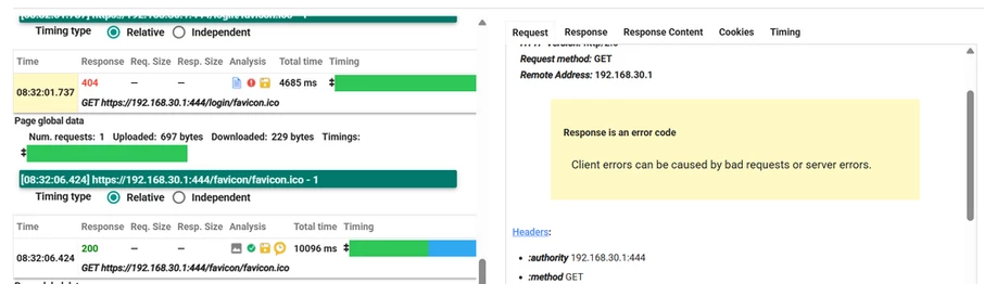

The HAR file may show a '404 error' and very high latency, even though the GET request eventually ends with 200 OK.
When this behavior occurs, the following debug for the HTTP authentication daemon can be captured to determine why the process is consuming high CPU.
