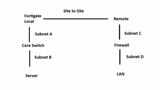

Example of the problem:
In this example:
There is a site-to-site IPsec VPN intermittent connection. There are only two Phase 2 selectors, namely: Subnet A to Subnet C, and Subnet B to Subnet D. On phase 2 debugging, a phase 2 mismatch is seen in the debug log.
Solution:
Add two more phase 2 selectors, namely Subnet A to Subnet D and Subnet B to Subnet C, and change IPSec from IKE v1 to IKE v2.
Result:
On phase 2 debugging, there is no more phase 2 mismatch, and there is no more site-to-site IPsec VPN intermittent connection.
