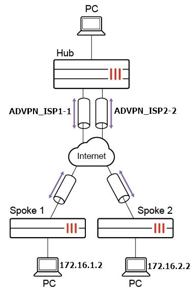

Description This article describes how to troubleshoot when shortcut tunnels cannot be established between spokes configured with ADVPN 2.0 and get an error message in IKE debugs, such as 'found duplicate in ike_check_update_addr_key'.
Scope FortiGate v7.4.2 and later.
Prerequisites:
  1. ADVPN 2.0 is configured across all the hubs and spokes.
  2. End-to-end connectivity between spokes via hubs.
In some circumstances, an otherwise valid shortcut may fail to establish a connection between Spoke1 and Spoke2. When the traffic is initiated from 172.16.1.2 towards 172.16.2.2, the Hub will send a SHORTCUT-OFFER to Spoke1:
