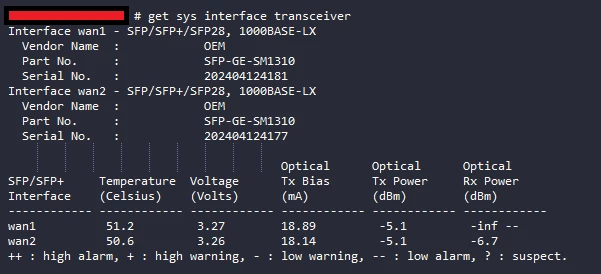

In this example, the FortiGate did not choose a port type for 'wan2':
Even though there is an SFP detected with valid RX and TX values:
In order to bring this interface up, manually change the port type by running the following command:
diag hardware shared-port <port> fiber/copper
