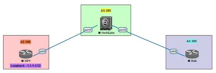

Consider the following topology where FortiGate has two eBGP neighbors established.
FortiGate has two eBGP neighborship, 10.21.7.58 is the ISP Router and 10.10.3.127 is the Hub Router.

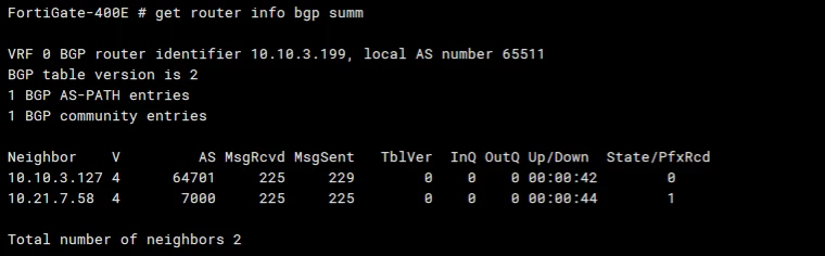

ISP Router is advertising subnet 1.1.1.1/32 to the FortiGate using BGP, which is received by the FortiGate and installed in the routing table:
FortiGate-400E # get router info routing-table bgp
Routing table for VRF=0
B 1.1.1.1/32 [20/0] via 10.21.7.58 (recursive is directly connected, port1), 03:08:37, [1/0]
But the FortiGate is not advertising this prefix to the Hub:
FortiGate-400E # get router info bgp neighbors 10.10.3.127 advertised-routes
% No prefix for neighbor 10.10.3.127
