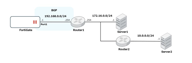

In the example diagram below, the FortiGate has a route to 10.0.0.0/24 and monitors connectivity by pinging 172.16.0.1.
If the Link Monitor fails, only the specified route using interface port1 and gateway 192.168.0.254 is removed.

In this configuration, even if the FortiGate retains a route to Server1, the route update may fail if the gateway-ip is not explicitly specified in the Link Monitor settings.
This is due to a difference in how routes are learned for polling versus route updates.
The polling function refers to BGP routes to reach Server1.
However, the route update function checks the gateway IP to reach Server1, which is not learned from BGP.
As a result, the route update may fail if the gateway IP is not explicitly specified.
As an exception, if a static route is configured, the route update will work even without a gateway-ip.
However, to maintain consistent policy across Link Monitor configurations, it is recommended to explicitly specify the gateway-ip.
