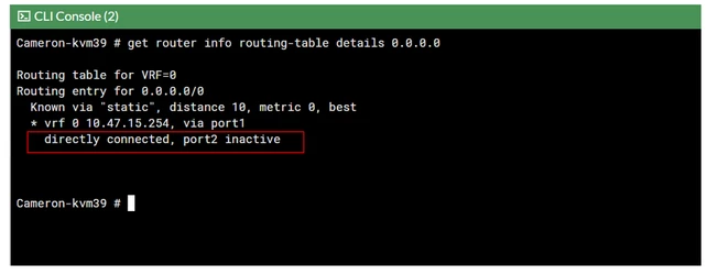

  1. From the output of the command, 'get router info routing-table details 0.0.0.0' the static route has been configured and is showing inactive at port2:

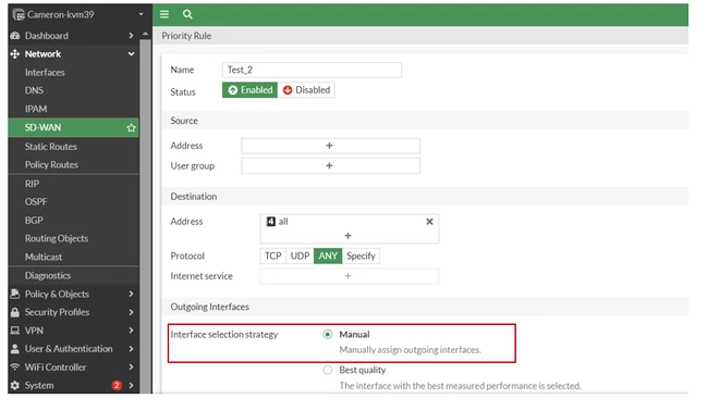

  1. A configured Performance SLA still runs even if all SD-WAN rules referencing the interface have an interface selection method that does not rely on SLA. In this example, the 'Manual' strategy is used, but port2 is still not selected to forward the traffic.

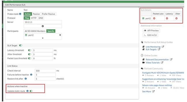

  1. When an SD‑WAN Performance SLA is assigned to an interface, FortiGate monitors its health. If the health check fails (no response to probes within timeout), and 'Update static route' is enabled, the system automatically removes or marks inactive the associated static route in the routing table. This behavior ensures traffic doesn’t route over unhealthy links, and so it is the default configuration for Performance SLA. If a route is being inactivated and that behavior is not desired, follow one or more of the following:
