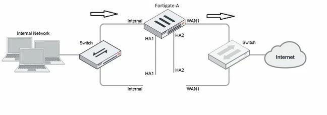

  1. Disconnect (all cables) from the HA cluster's FortiGate-B. (The secondary FortiGate with serial terminal FG-SERIALXXX_B).
  1. Leave only the Fortigate-A connected (Active FortiGate with serial terminal FG-SERIALXXX_A). This equipment will remain operational to avoid services being affected. See Figure 1:
Note: If the cables are not labeled, proceed to identify them to avoid confusion when reconnecting them later.

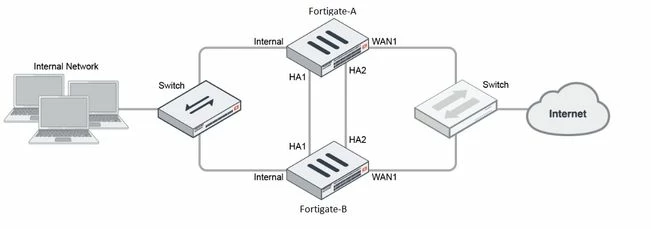

  1. Once these configuration settings have been made and verification has been performed, physically connect the secondary device (FortiGate-B) to the HA cluster and wait for it to sync. See Figure 2:
