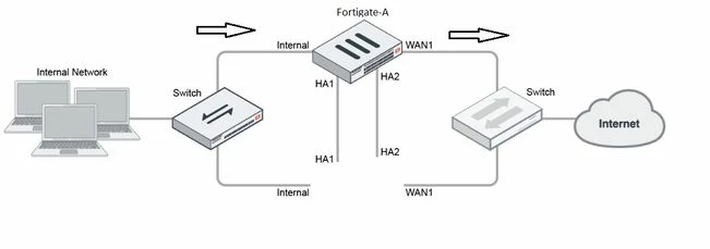

  3. Disconnect (all cables) from the HA cluster the Fortigate-B. (Secondary Fortigate with serial terminal FG-SERIALXXX_B).
  4. Leave only the Fortigate-A connected (Active FortiGate with serial terminal FG-SERIALXXX_A). This equipment will remain operational to avoid service affectation. See Figure 1:
Note: If the cables are not labeled, proceed to identify them to avoid confusion when reconnecting them later.

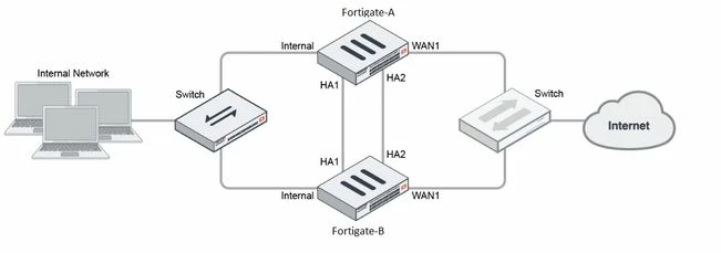

  1. Once these configuration settings have been made and verification has been performed, physically connect the secondary device (Fortigate-B) to the HA cluster and wait for it to sync. See Figure 2:
  2. If the units DO NOT sync, open a ticket with support and call support for immediate assistance.
