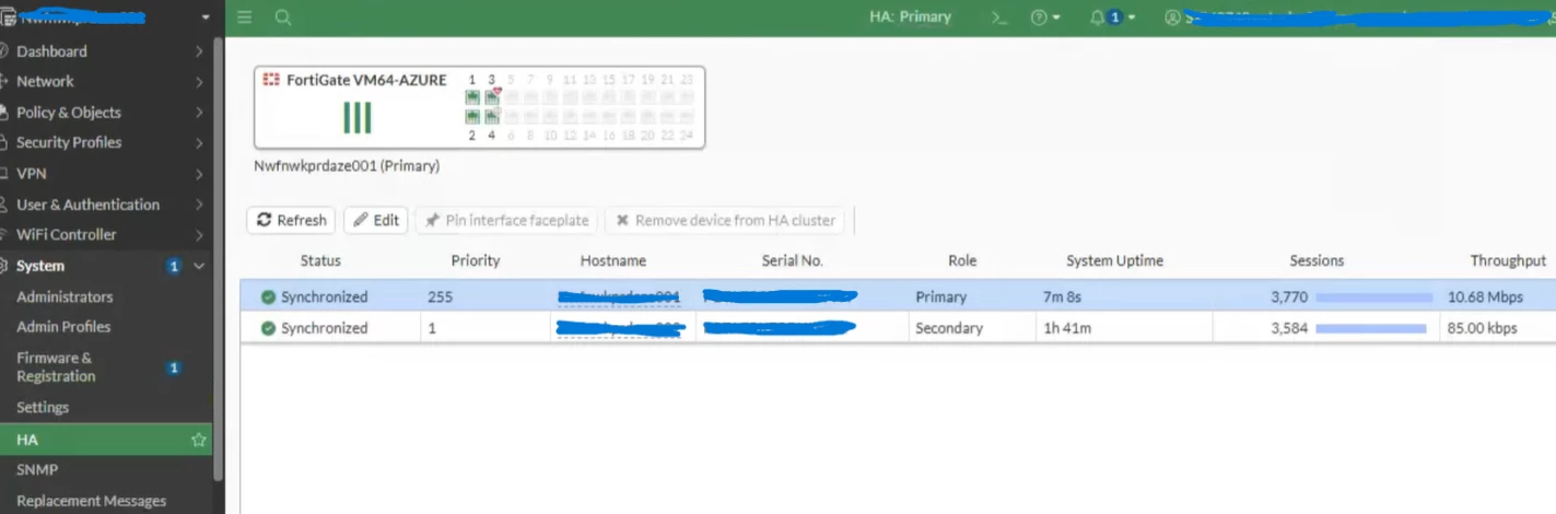

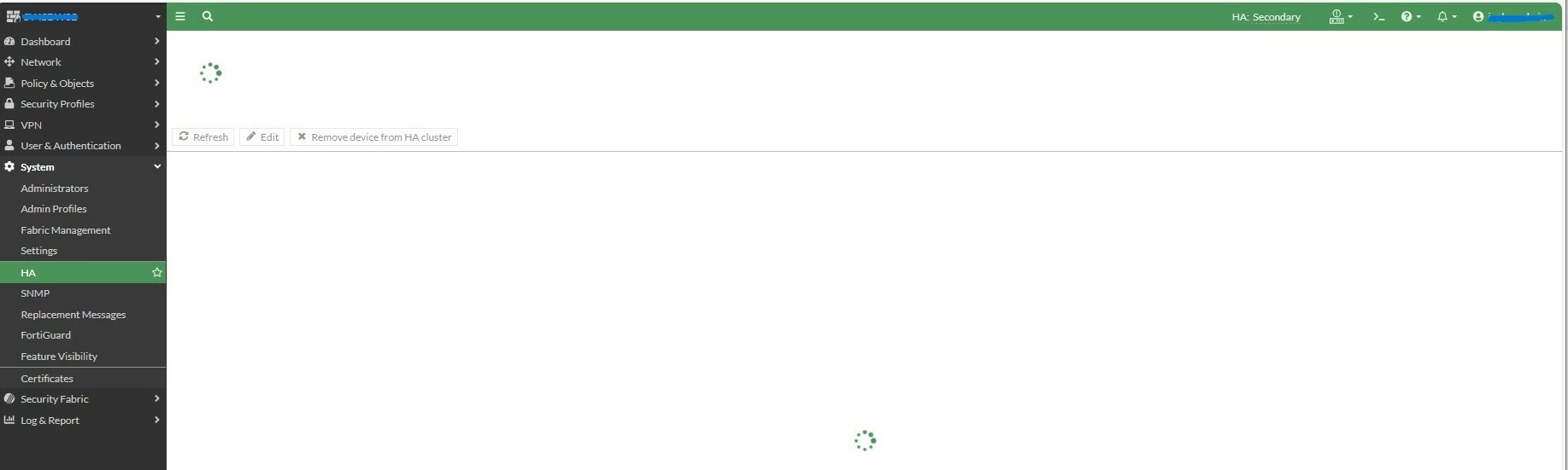

After upgrading the firmware, the System -> HA page fails to load in the GUI on both primary and secondary devices. The behavior does not impact failover operations or lead to a split-brain scenario

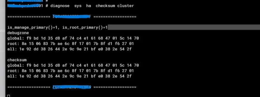

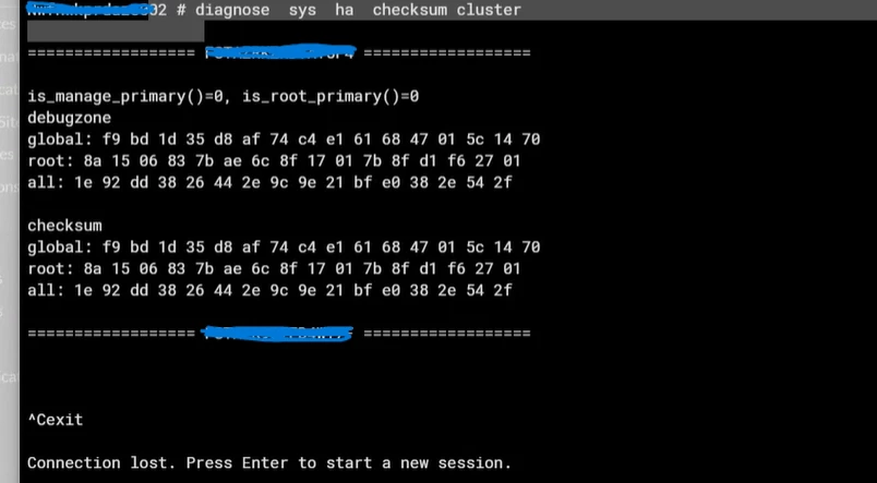

When reviewing the HA checksum cluster on both devices, the secondary unit is not appearing in the HA cluster, and checksum verification may show the unit as missing or displaying incomplete output, and the issue is mirrored vice versa.
This behaviour occurs when HA-Sync fails to establish effective communication between the two devices. Ensure both units are running the same firmware version by using the get system status command.
