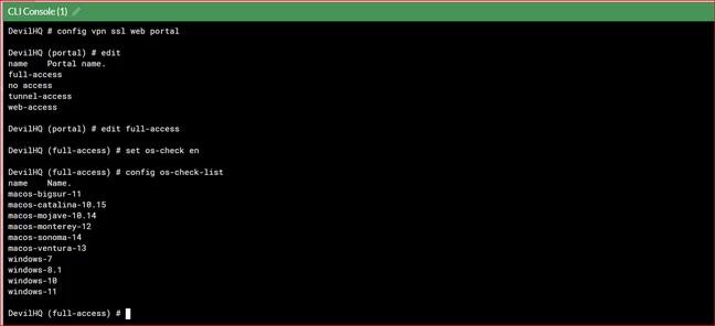

This article describes an issue where the users might not be able to configure host check for the new macOS Sequoia 15.0 in SSL VPN configuration on FortiGate.
FortiOS v7.2.x, v7.4.x and v7.6.x.
While configuring the host check in SSL VPN, the new release of the macOS Sequoia 15.0 is not included in the OS checklist for the SSL VPN in the current FortiOS.
The screenshot is attached below for reference.

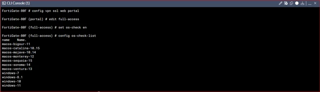

MacOS Sequoia 15.0 is included in the FortiGate Firmware versions 7.2.11, 7.4.7, and 7.6.1.
Below is the screenshot attached for the firmware v7.6.1.
