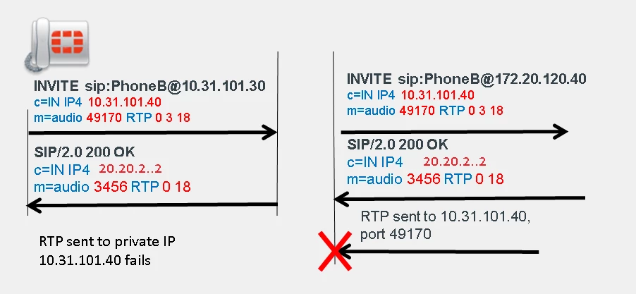

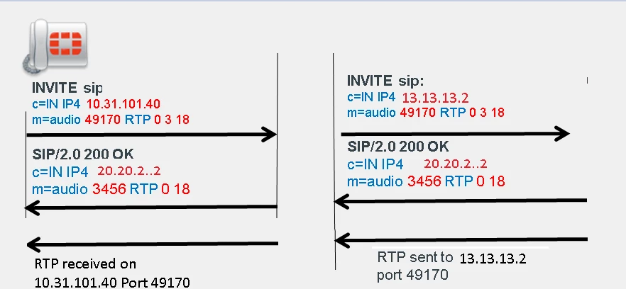

SIP ALG is required:
Both sides send Connection Information (c=IN) to establish an RTP/Audio session. If a private IP is sent in the connection information, RTP traffic on the private IP will fail.
When SIP ALG is enabled (default), the Firewall will perform layer 7 Translation on the private IP in the SDP header to a public IP (this is expected and recommended).

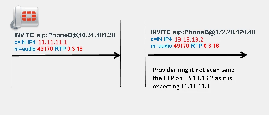

The issues arise when the phones or the local PBX are already configured to send the Public IP in c=IN, meaning the firewall translates that IP as well when SIP ALG is enabled.
In these cases:
  • Do not configure local PBX with the public IP of the location.
Or:
  • Keep SIP-ALG enabled as recommended but disable SDP translation for SIP traffic in the VoIP profile (if no custom VOIP profile is configured, the 'default' profile is used).
Or:
  • Disable the SIP ALG to disable all Layer 7 translations.
