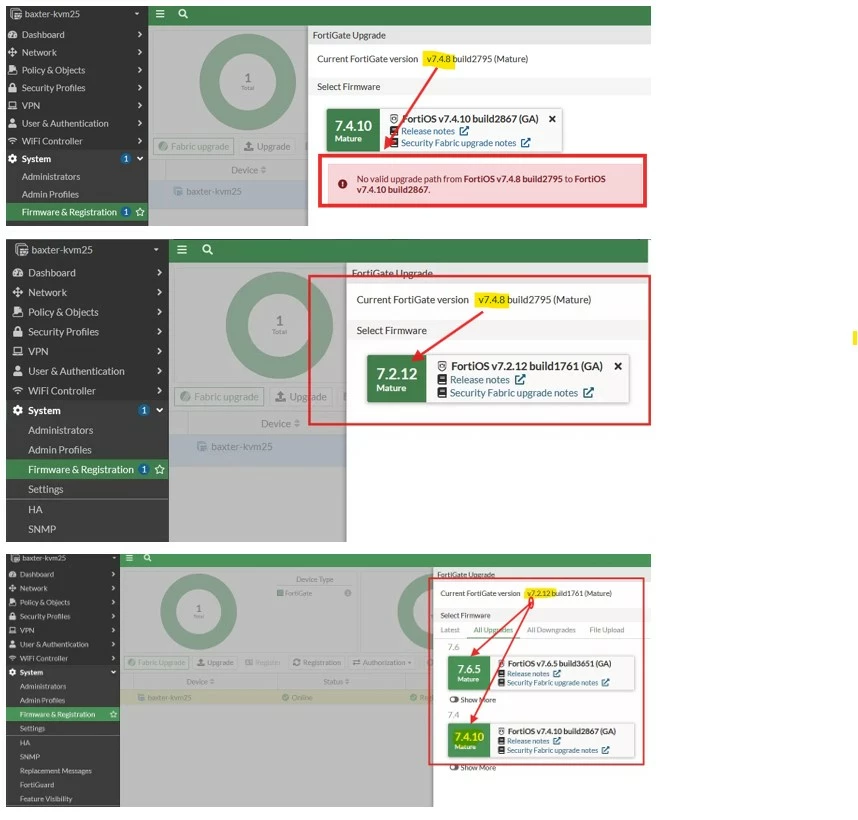

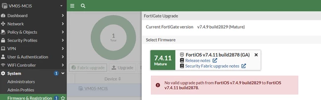

Example upgrading FortiOS from v7.4.8 or v7.4.9 to FortiOS v7.4.10 or 7.4.11:

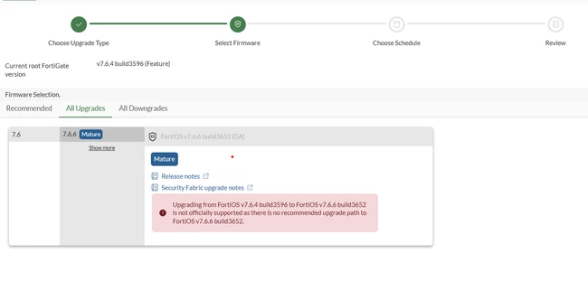

Attempting to upgrade a VM and hardware from FortiOS v7.4.8 or v7.4.9 to v7.4.10 or v7.4.11 shows the following error in the GUI: 'No valid upgrade path from FortiOS v7.4.9 build2829 to FortiOS v7.4.11 build2878'.
However, the upgrade path from v7.4.9 to v7.4.11 is supported for this platform. The same applies to upgrading from v7.6.4 to v7.6.5 or v7.6.6.

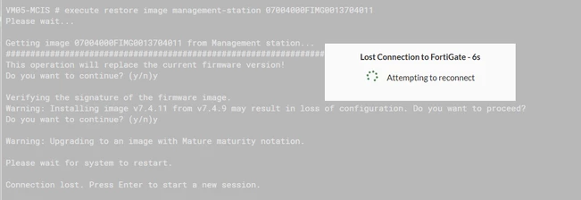

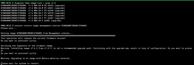

The workaround is to upgrade the FortiGate-VM using the CLI command 'execute restore image management-station <image_id>'. To do this, follow the steps below:
  1. Verify the upgrade path manually using the Upgrade Path Tool Table or the support site, see the article Technical Tip: How to verify FortiGate Upgrade path to upgrade the FortiGate to a higher Firmware Version.
  2. Upgrade each step in the upgrade path manually using one of the following methods:
Example upgrading FortiOS v7.6.6 to v8.1 using management-station:
FortiGate-80F #  diagnose fdsm image-list | grep v8
08000000FIMG0027600001  v8.0 GA-F P1 b0245 (upgrade)
08000000FIMG0027600000  v8.0 GA-F b0167 (upgrade)
FortiGate-80F # execute restore image management-station 08000000FIMG0027600001

Alternative method for firmware upgrade (workaround):
  1. Downgrade the device to FortiOS v7.2.x release (for example, v7.2.12).
  2. After the downgrade is complete, perform a direct upgrade to either v7.4.10 or v7.6.5.
This upgrade path has been validated to complete successfully without further issues (refer to the screenshots below).

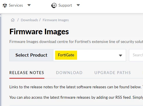

If the alternative method (workaround) fails, the only option is to upgrade by manually downloading the firmware image:
Firmware images for all FortiGate units are available on the Fortinet Customer Service & Support website.
To download firmware:
  1. Log in to the support site with a username and password.
  2. Go to Support -> Firmware Download. A list of Release Notes is shown. Download and review the Release Notes for the firmware version being used to upgrade the FortiGate unit.
Note: Select FortiGate under Select Product as shown below:
