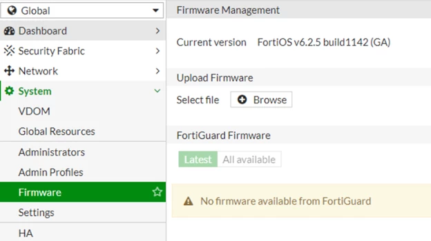

Troubleshooting Tip: No firmware available from FortiGuard under firmware management
  • January 28, 2021
  • 1 reply
  • 30725 views
This article describes how to resolve a scenario where no new firmware is listed in the Firmware Management section of the GUI.
FortiGate, FortiGuard.

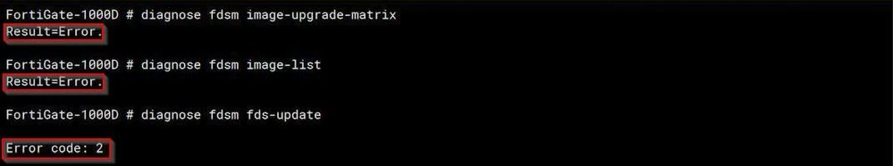

  1. Run the following commands to make sure that the FortiGuard Distribution Network has the images updated on FDN Servers.
diagnose fdsm image-upgrade-matrix
diagnose fdsm image-list
diagnose fdsm fds-update
The above commands will list all the compatible firmware images & versions that are retrieved from FDN. If this is successful, there will be no issues communicating with the FortiGuard distribution list.
In case of a new device, such as the G series, and there is no available upgrade/downgrade path, the result will show an error for those commands.
The above issue (screenshot with 'Result=Error') may also be seen sometimes when the unit is having difficulty connecting to FortiGuard services.

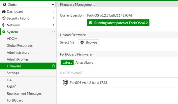

  1. allow-remote-firmware-upgrade is enabled by default. If it was disabled previously, enable it by running the following command:
    set allow-remote-firmware-upgrade enable
This will enable remotely upgrading the firmware on this FortiGate from the central management server (FortiGuard by default).
After this change, it will be possible to find the recommended firmware:
If FortiGuard Firmware is still not available, it may be because the current FortiOS version has reached End of Support (EOS). In this case, manually upgrade the FortiGate to a supported version. After that, all the images should be visible.
