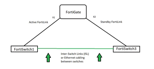

Since FortiSwitch1 and FortiSwitch3 are not physically connected, the Active FortiLink cannot discover the LLDP messages coming from FortiSwitch3 in the figure above. As a result, LLDP messages cannot be negotiated by FortiGate's 802.3ad aggregate interface with FortiSwitch3 and brought up for authorization on FortiGate.
Since the Standby FortiLink is administratively down and only utilized for redundancy, it will not handle any CAPWAP traffic and is therefore unsuitable for receiving LLDP traffic on the FortiGate.
To fix this, FortiSwitch units must be linked together in a ring-like or 'daisy-chain' topology using inter-switch links (ISL) or must be connected with an Ethernet cable. This physical topology change will resolve the issue. See the diagram below:
