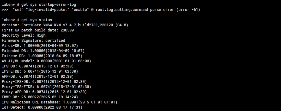

This article describes how to handle the error ''set 'log-invalid-packet' enable' @ root.log.setting:command parse error (error -61)' after a firmware upgrade to v7.4.x.
Scope FortiGate v7.4.
After a firmware upgrade from v7.0.x/v7.2.x to v7.4.x, the 'log-invalid-packet' command could not be parsed.

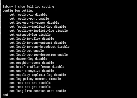

There is no 'log-invalid-packet' command available in v7.4.x:
The command has been renamed to 'extended-log' in v7.4.0 and above.
To re-enable the feature in version v7.4, use the following commands:
config log setting
    set extended-log enable
