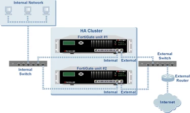

Figure 1.
Typical HA configuration, each interface connected to a different switch

In Figure 1, FortiGate #1 and FortiGate #2 are running as an HA cluster.
The internal interfaces of both FortiGates are connected to the internal switch.
The external interfaces of both FortiGates connect to the external switch.
In this configuration, the HA cluster works with any layer-2 switches from any vendor.
There are no issues associated with virtual MAC addresses in this configuration.
