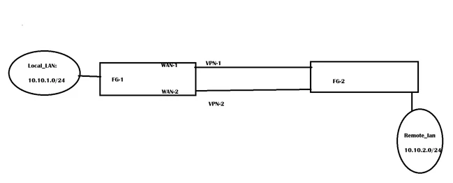

  1. Use the same distance value for multiple IPsec tunnels and keep different priorities for static routes associated with tunnels.
Example:
In the above diagram, the static routes on FG-1 have to be set up with the same distance for both VPN-1 and VPN-2, and different priorities. The route with the lowest priority will be preferred.
In this scenario both the routes and tunnel will be in active state.
