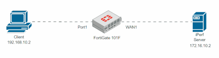

In the setup below, FortiGate-101F is selected as the device, and the iperf speed test is between the  Windows client connected on port1 and the Windows server connected on wan1.
iPerf must be available on both endpoints. One device (172.16.10.2) will run iPerf in server mode, while the other device (192.168.10.2) will run it in client mode.

Additionally, a firewall policy needs to be configured on FortiGate-101F between the source interface, port1,  and the destination interface, wan1.
