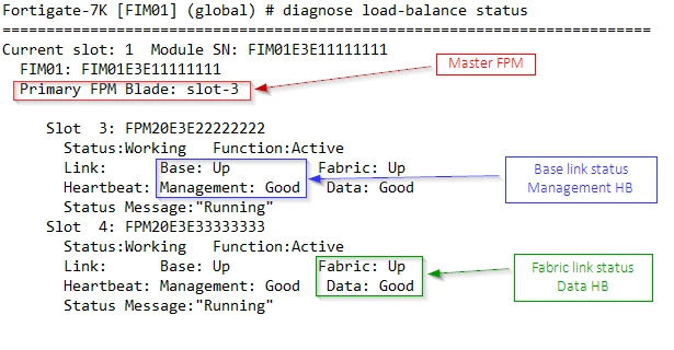

Solution The command diagnose load-balance status provides an output as follows:
FortiGate7K (global) # diagnose load-balance status
Slot X
Status:Dead Function:Active
Link: Base: Up Fabric: Up
Heartbeat: Management: Good Data: Failed
Status Message:"Waiting for data heartbeat."

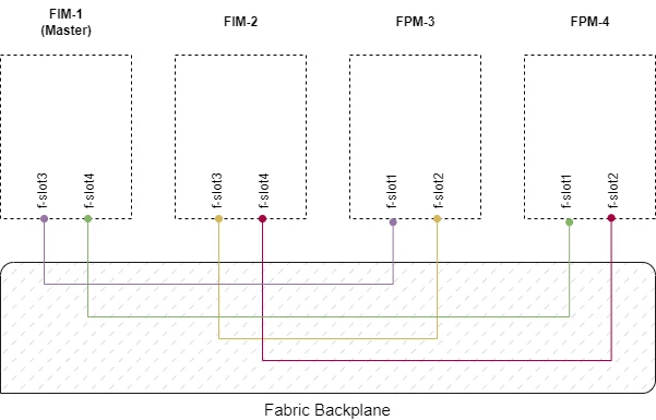

Inside a FortiGate 7K Chassis, two internal switches coexist :
  • The Base backplane: Used for management and administration inside the Chassis.
  • The Fabric backplane (also named Data backplane): Handle the user traffic, where the data transits.
Each FPM exchanges management heartbeats with both FIM1 / FIM2 simultaneously using respectively its interface f-slot1 and f-slot2.
The Master FIM will use the interface f-slotX where X is the FIM number.
For example on the Master FIM f-slot3 is used to communicate with FPM3, and f-slot4 for FPM4.
Packets are ethertype 0x8990 sent using an Ethernet multicast 01:80:c2:00:00:0c destination MAC.
The following diagram details the Fabric Backplane:

The sniffer above shows that heartbeat packets are correctly sent and received on the Master FIM.
