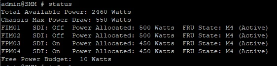

- The status command will print out the power status of the current SMM module. (FGT-7060E units have SMM1 and SMM2 and only one can be active. On the passive SMM, the status command will display the message 'SMM is inactive').

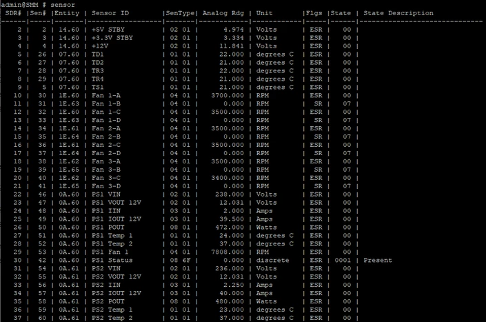

The sensor command will print out the current analog reading of each sensor. Some of the sensors can also display a description (PSU status can show as one of the following: Present, Absent, Input-Lost).

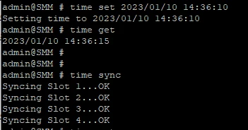

- The time get command will display the current SMM time and date.
- The time set <yyyy/mm/dd hh:mm:ss> command will set the SMM time and date.
- The time sync command will synchronize each slot with the current SMM time and date (FortiOS time is managed by the NTP config in FortiOS and can be different from the SMM time).

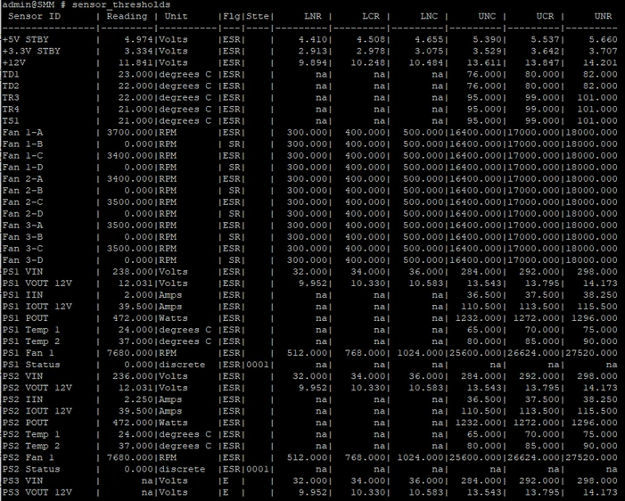

The sensor_thresholds command will display the lower (L) and upper (U) thresholds of each sensor. The screenshot below is taken from a FortiGate 7040E unit with PSU1, PSU2 and PSU4 installed, and with an absent PSU3.
- Lower Non-Recoverable (LNR)
- Lower Critical Recoverable (LCR)
- Lower Non-Critical (LNC)
- Upper Non-Critical (UNC)
- Upper Critical Recoverable (UCR)
- Upper Non-Recoverable (UNR)

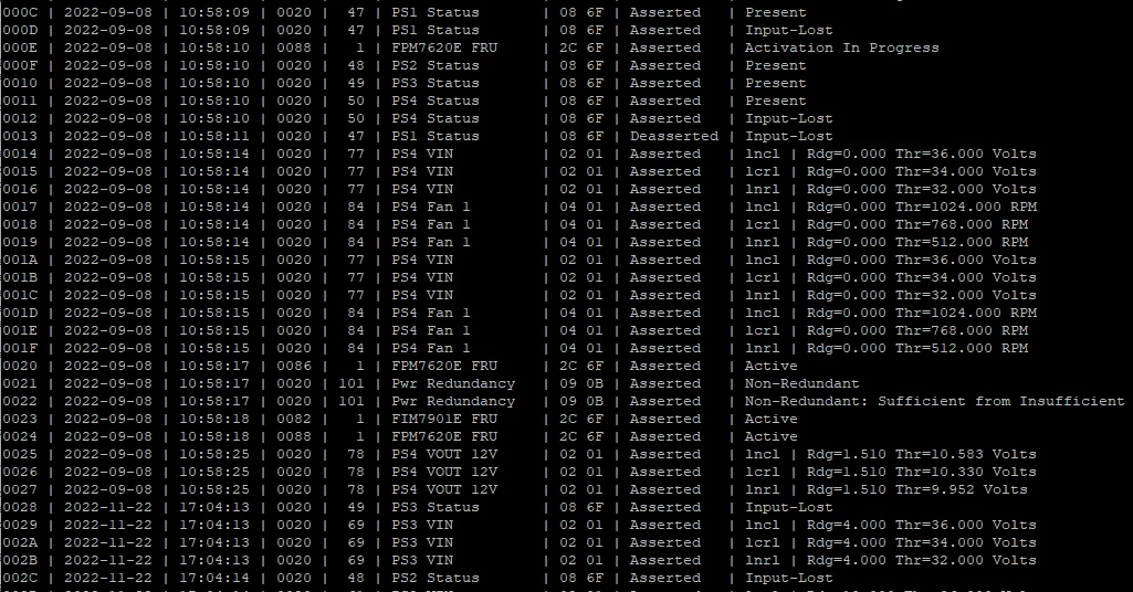

- The sel command will display the SMM system event logs. Information such as which PSU went down or which FPM or FIM lost power can be found here, along with related timestamps (assuming that the SMM time/date is correctly set). The screenshot below is taken from a FGT-7060E with 4 PSUs (3+1 configuration). Note that the sel command output can be very long. Do not interrupt it, the most recent logs are shown at the end.
The FortiGate7060E has two SMM modules (SMM1 and SMM2) and only one can be active at any time. The other one acts as standby SMM. If the related sel logs cannot be found in one SMM, a SMM switch-over using the command smm_switch can be forced to make the other SMM active and collect the sel logs from the other SMM module. Once switched over you need to move the cable to the other SMM to access its SMM console (physical access to the chassis unit will be necessary).
