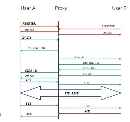

SIP calls getting disconnected within 30 seconds after being answered is a symptom that the 3-way handshake for the INVITE/call establishment (INVITE/200 OK(INVITE)/ACK) did not complete and that the remote party did not receive the ACK packet in within 30 seconds after sending the 200 OK message - the remote party is the one disconnecting the calls.
Below is the call flow for SIP:
This issue is not a FortiGate issue:
  • For outbound calls, the issue needs to be analyzed on the internal PBX/Phone side.
  • For inbound calls, the issue needs to be analyzed on the remote PBX or VoIP provider's side.
