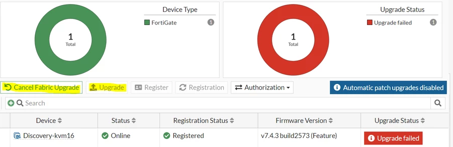

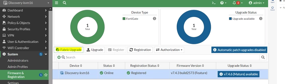

When navigating to System -> Firmware & Registration and selecting Fabric Upgrade as highlighted:

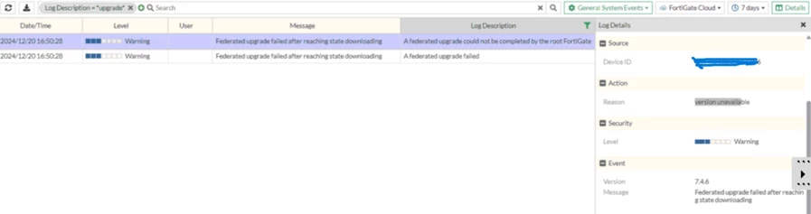

The following error may be observed in the logs: A federated upgrade could not be completed by the root FortiGate
  • because: version unavailable.
  • message: Federated upgrade failed after reaching state downloading.

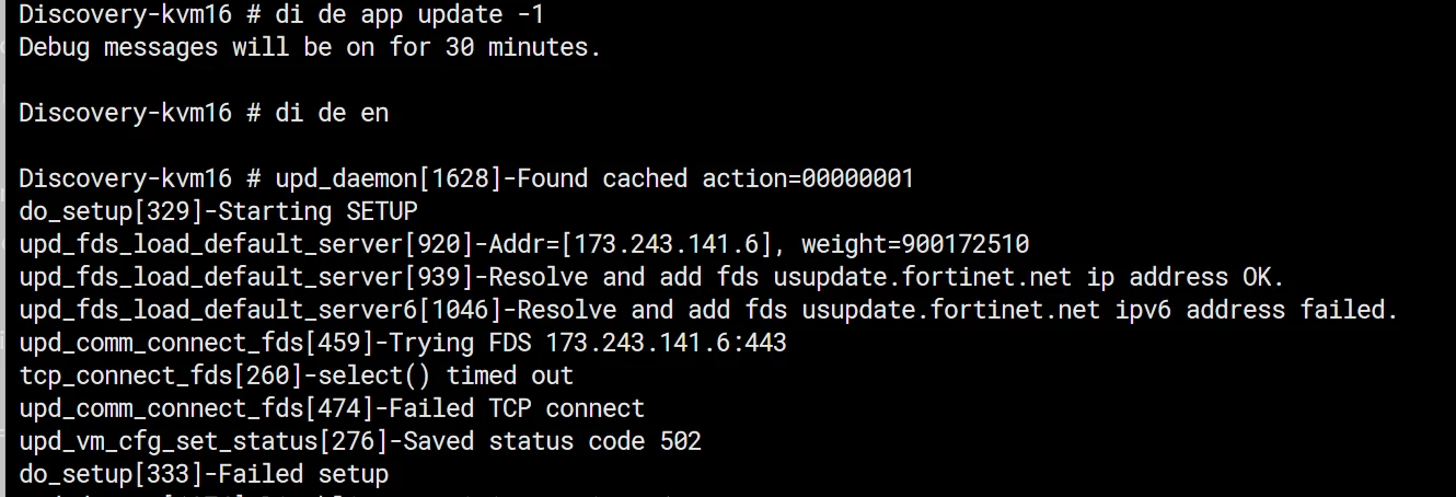

To diagnose this issue, collect the following logs:
diagnose debug disable
diagnose debug reset
diagnose debug app update -1
diagnose debug console timestamp en
diagnose debug en
Errors may include:
  1. Image Verification Failures.
  2. FortiGuard Connection Issues i.e.
To troubleshoot FortiGuard issues, refer to the following: FortiGuard Troubleshooting

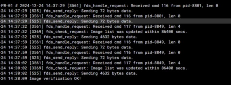

The following screenshot highlights the expected output before the firewall executes the Federated Upgrade:
