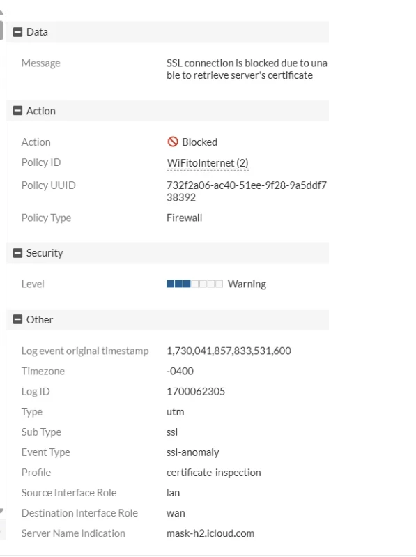

After upgrading to v7.4.5 or v7.2.12, users may start experiencing connection failures to websites in the form of connection resets (e.g. ERR_CONNECTION_RESET). In the FortiGate Security Events -> SSL Logs, there may be log entries with Log ID 1700062305 and the message 'SSL connection is blocked due to unable to retrieve the server's certificate.

As of v7.2.11, v7.4.5, v7.6.1 and later, the cert-probe-failure setting now applies to Firewall Policies using flow-based inspection. However, this means that any FortiGate sites that used flow-based Firewall Policies and were already having TLS probe failures could suddenly start to experience connection issues after performing a firmware upgrade. When this occurs, the Forward Traffic logs will show web traffic sessions being blocked, and the associated SSL logs in the Security Events will show the following message:
SSL connection is blocked due to an inability to retrieve the server's certificate.

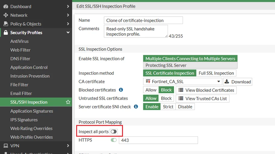

  • If inspect all ports is toggled on in the GUI (aka set inspect-all in the CLI), then the cert-probe-failure option will not be available. Note that this option only has an effect when using proxy-based inspection for Firewall Policies (as it has the IPS Engine perform inspection before handing traffic over to the WAD daemon), so it is free to disable for administrators using flow-based policies. Consider disabling the inspect-all option in this case to allow the cert-probe-failure option to be configured:
config firewall ssl-ssh-profile
    edit <profile_name>
        config ssl
            unset inspect-all

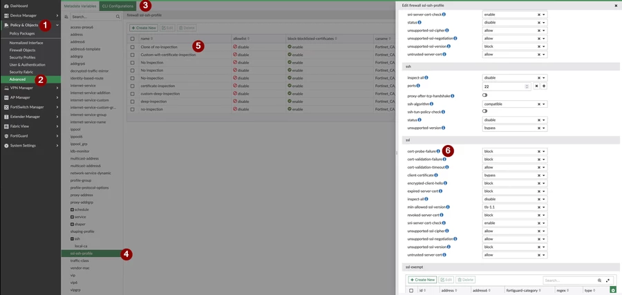

To push this configuration to multiple units (FortiGates) via FortiManager, refer to the following procedure:
  1. Select Policy & Objects.
  2. Select Advanced.
  3. Select CLI Configurations.
  4. Navigate to the SSL-SSH profile.
  5. Choose the cloned Certificate Inspection profile (ensure a non-read-only profile is selected).
  6. Under SSL, set cert-probe-failure to Allow.
After following these steps, push the SSL-SSH profile-related configuration to the desired FortiGate units via FortiManager.

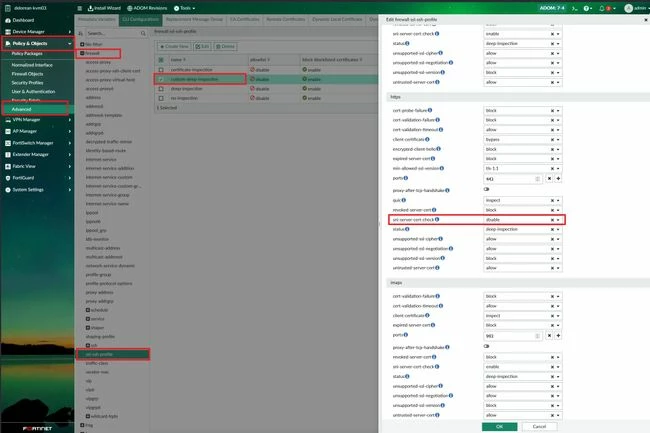

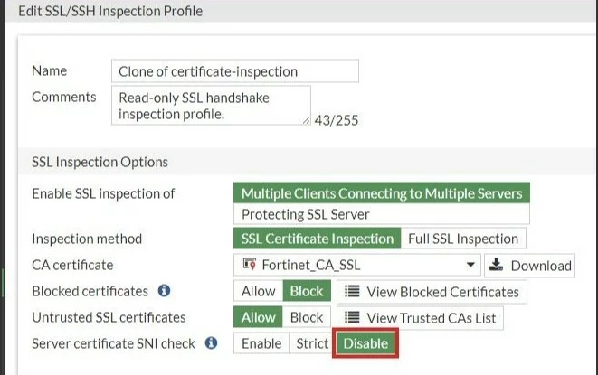

Solution 2: sni-server-cert-check:
As an alternative to setting cert-probe-failure to allow, administrators could also consider setting sni-server-cert-check to disable, as disabling SNI checks will also prevent TLS probing from being performed at all.
To do this, create/clone an SSL inspection profile and either toggle off Server certificate SNI check in the GUI or run set sni-server-cert-check disable in the CLI. Once this is done, assign the new SSL inspection profile to the flow-based Firewall Policies:
    edit <profile_name>
        config https
Similar to Solution 1, this change can also be pushed via FortiManager:
Note: Disabling the SNI check should be done with caution. When disabled, FortiGate will not verify if the SNI in the client hello message matches the Common Name (CN) or Subject Alternative Name (SAN) fields in the server's SSL certificate. Without SNI verification, the FortiGate cannot use the SNI to perform URL filtering based on the CN in the server certificate. This may lead to inaccurate web traffic classification and filtering.
