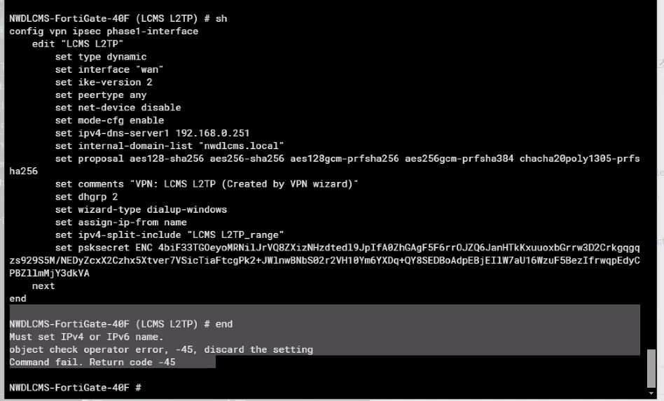

Troubleshooting Tip: How to fix error "Must set IPv4 or IPv6 range. object check operator error, -45, discard the setting Command fail. Return code -45"
  • October 28, 2024
  • 1286 views
This article describes how to resolve a common error encountered while configuring an IPsec dial-up tunnel on FortiGate when mode-cfg is enabled.
Scope All FortiGate firmware version.
When mode-cfg is enabled, FortiGate acts as a DHCP server for VPN clients, dynamically assigning IP addresses and other network configuration details. To avoid the error, it is essential to configure the ipv4-start-ip and ipv4-end-ip range (or the equivalent IPv6 range, if applicable).
For instance,
edit <vpn tunnel>
set ipv4-start-ip X.X.X.X <- Where (X.X.X.X and Y.Y.Y.Y is starting and ending IP range).
set ipv4-end-ip Y.Y.Y.Y
After setting the IP range, the error should no longer appear.
