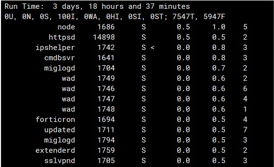

- Run the CLI command 'diagnose sys top 1 45 199' to find memory usage per process instance.
'1' stands for refreshing period in seconds
'45' stands for a number of processes displayed. See part of it as example below:
'199' stands for the number of times the command is repeated before stopping
Process name, Process ID, Process state, CPU usage %, and Memory usage %; the last column is the CPU core on which the process is running. By default, processes are sorted by CPU usage (4th column). To sort processes by memory usage (5th column) to find out which process is consuming the most memory resources, press Shift + M, and for cpu Shift + P.
Check % of memory usage to see if any process is constantly using an unreasonably high fraction of memory, which may be the process causing the issue.
Note 1:
Some processes can have multiple instances, like 'miglogd' in the example above. WAD and IPSengine are also such processes.
In such cases, sum up the total memory usage for all instances, and it should not exceed -20 -25%, but it depends on the device and its total memory - for small devices with a small amount of memory, it might be normal. Security profiles like Web filtering and antivirus can increase memory usage.
diagnose sys top | grep miglogd <----- Use grep to group all instances with process name <miglogd>.
