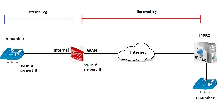

Voice call has two legs.
To troubleshoot, analyze each leg to identify if there are voice problems in internal or outside FortiGate network.

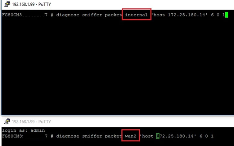

1) Use the following command:
#diag sniffer packet [Int] ‘host [IP IPPBX]’ 6 0 l

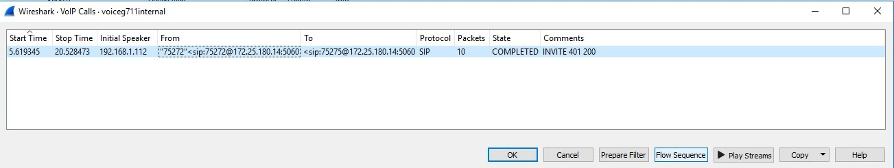

4) Open file in Whireshark and select Call -> Telephony -> VoIP Calls.

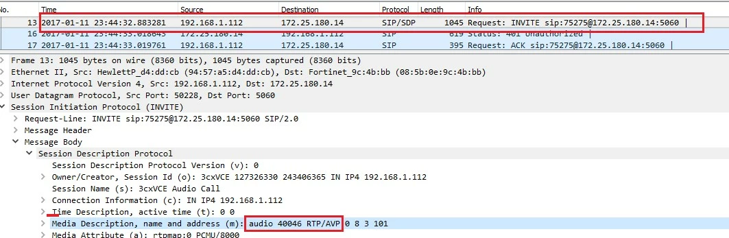

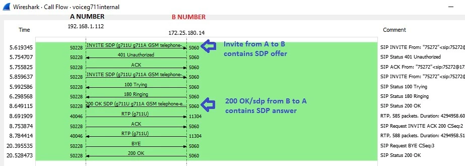

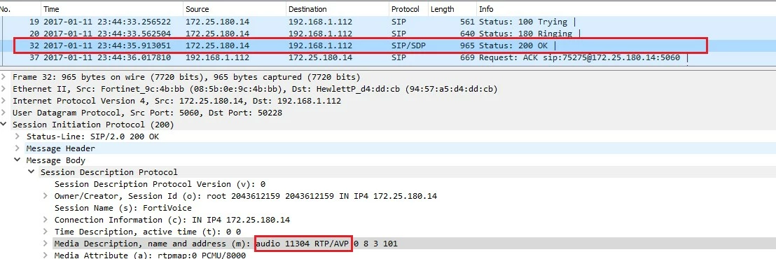

5) Find SIP messages invite (from A to B)  and 200OK/SDP (From B to A) it will contains SDP with codec and UDP ports that was used for RTP (audio).
6) Invite (from A to B) in SDP field 'Media Description' shows port used for RTP from phone device side and codec proposed for it.
7) 200OK/SDP  (from B to A) in SDP field 'Media Description' contains codec selected or supported by far end (it must be G711A(PCMA=0) or G711Mu(PCM=U) and RTP ports from FortiGate side.

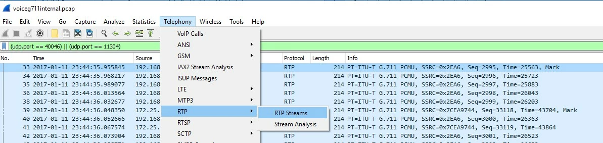

8) Once that RTP port from pone device and fortiGate has been found, apply filter in Whireshark for these ports.
 (udp.port == 40046) || (udp.port == 11304)

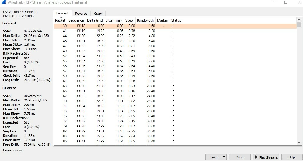

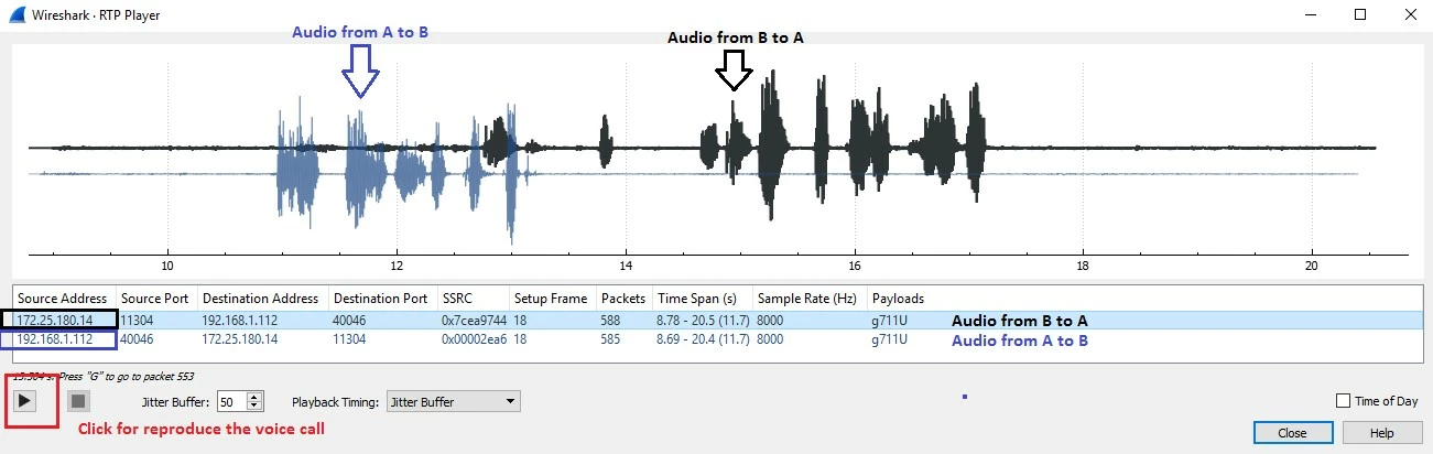

9) Select Telephony -> RTP -> RTP Streams.
10) Select both and select 'analyze', after select first packet and click 'play streams'.
Audio will be displayed and conversation is reproduced from one side (from A to B or B to A) or both simultaneously.
